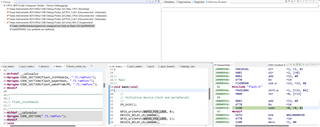

Question 1: In debug mode, CPU1 can jump between APP and bootloader normally, but CM will enter faultISR or defaultISR when jumping from one project to another (CM's APP has transplanted the lwip_udp protocol to realize network port communication).
Question 2: exit function does not work:

    After comparing the CM project's bootloader to the CM Flash kernel bootloader, I noticed that the exit() function is being placed in flash as .text. Does this have the same effect if the function is placed in S0RAM or S1RAM in the linker cmd file?
    The map file for the CM Bootloader also shows four far trampoline calls for some flash initialization functions.

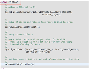

    About question3, It is because the following part of the code is used in the CPU1_APP project, which causes the function IPC_sync() to fail during the jump process.
    In order to better illustrate this question, the customer re-uploaded a compressed file: ⇒ 0334.appTest.zip ⇐
    This compressed file contains 4 projects: CPU1_APP, CM_APP, CPU1_BOOTLOADER, CM_BOOTLOADER

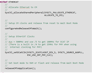

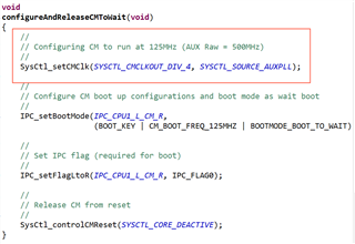

    There are the following two parts of code involving ETHERCAT, both in the CPU1_APP project:
    The first picture is if ETHERCAT is not used, set the auxiliary clock to 125M and the CM clock to divide by 1.
    The second picture shows that if ETHERCAT is used, the auxiliary clock of the first picture is set to 500M, and the CM clock is divided by 4.
    Customers have already used the method you mentioned, and here are a few situations they encountered:
    1. If ETHERCAT is not used in the CPU1_APP project, that is, the auxiliary clock is set to 125M, and the CM clock is divided by 1. The CM jump situation is that the bootloader project can jump to the APP project, but the APP will enter when it jumps to the bootloader. faultISR interrupt.
    2. If ETHERCAT is used, that is, set the auxiliary clock to 500M, and the CM clock frequency is divided by 4.
    In this case, the CM jump situation is: when jumping from the bootloader to the APP, the following situation will occur:
    Therefore, the customer has tried the above two situations, but neither of them can jump normally.
