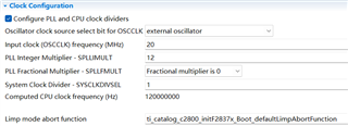

TMS320F28075 system clock settings in the form of XGCONF is shown as follows
The corresponding cfg script is shown as follows

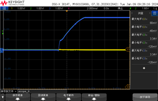

The comparison of the detected power sequence whether the problem occurs is shown as follows(among all the power-on related pins, choose a VDDIO pin(CH2), a VDDA pin(CH3) of the TMS320F28075 as the measurement object, CH1 is a SPISOMI pin of the TMS320F28075)
The detected power sequence when the ClkCfgRegs is normal
The detected power sequence when the ClkCfgRegs is abnormal
This problem is more likely to occur when the current limit of the constant voltage power supply is set above 1A, which means that the voltage level rises faster. The maximum supply ramp rate in the above abnormal power sequence is 4000v/s, which is in the range of the requirement.
The power supply is stable and the external oscillator is normal after the control board was powered up even when this problems occurs. The picture is shown as follows.
  • I recommend disabling the SYS/BIOS Boot module's clock configuration and instead using the latest clock init functions from C2000Ware. I suspect the SYS/BIOS version of the clock init code is missing some of the workarounds discussed in the errata for the PLL.
