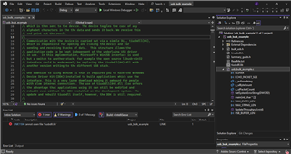

    I generated a new project in Visual Studio (Visual c++) where I added the example code usb_example.c and tried to compile it using the "release" option, this gave me an error.
    How can I solve it?
    Regards.
    This lib is located at C:\ti\c2000\C2000Ware_5_01_00_00\utilities\tools\usb\tiusbdll\Release
    You will have to add this to your Visual Studio project.

    I already have that library added, in fact, by zooming in on the previous image in the "Solution Explorer" section you can see this library. However, the code still shows the same error.
    Regards.
    Pls check if the include path is correctly configured in the Project settings. The include directory should have a path added for the tiusbdll.lib

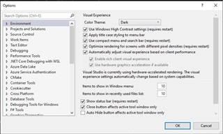

    How can I check if the inclusion path is configured correctly in the project configuration? That is, how can I access the tab you show in the image through the toolbar in Visual Studio?
    The tab I accessed through the toolbar is the following one, however it does not seem to be the same. Does it have something to do with the version of Visual Studio I am using or am I simply accessing the wrong tab? In my case the version of Visual Studio is 2022.

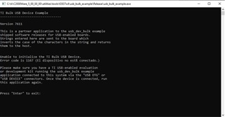

    I also add the error that is shown when using the .exe file from the "Release" folder.
    In the following link
    https://e2e.ti.com/support/microcontrollers/arm-based-microcontrollers-group/arm-based-microcontrollers/f/arm-based-microcontrollers-forum/365829/usb_bulk_example-exe-with-tm4c123g-dev-bd
    The user mentions the following:
    "I change the USB port to USB-OTG is OK",
    Is this completely necessary to make this example work?

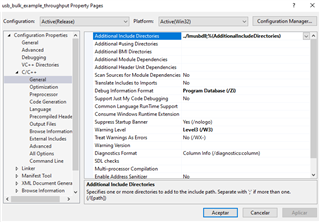

    I already checked that the path is correctly configured. The configuration is the same as the one you present in your image, however the same error continues to appear, I leave evidence below:
    Thank you,
    Regards.

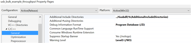

    Looking at the snapshot , the Additional Include directories needs to be updated as below
    • Instead of "lmusbdll" , update the setting to specify "tiusbdll"  (../lmusbdll to ../tiusbdll)
