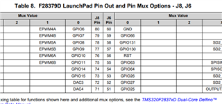

    The GPIO6 is shown to be connected to PIN 80 (J8) as shown in the picture below. My assumption is based on this datasheet.

    If you look at the function definitions , the first argument to the GPIO_SetupPinMux, GPIO_SetupPinOptions and GPIO_WritePin is the gpioNumber and not the pin number.  Hence you can change it to GPIO6 and try.
    Also, the snapshot that you shared indicates that GPIO6 is connected to pin80 on the LaunchPad and not of the device.
