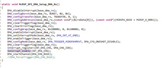

static void McBSP_SPI_DMA_Setup_DMA_Rx()
    // Configure DMA Channel 2 (16 - bit datasize).
    DMA_disableInterrupt(base_dma_rx);
    // Configure 1 word per burst.
    DMA_configBurst(base_dma_rx, BURST, 0U, 0U);
    // Configure 127 bursts per transfer.
    DMA_configTransfer(base_dma_rx, TRANSFER, 0, 1);
    // Dest start address = buffer & Src start address = MCBSPA DRR
    DMA_configAddresses(base_dma_rx,(const void*)(&(rxData[0])), (const void*)(MCBSPA_BASE + MCBSP_O_DRR2));
    // Clear peripheral interrupt event flag.
    DMA_clearTriggerFlag(base_dma_rx);
    // Clear sync error flag.
    DMA_clearErrorFlag(base_dma_rx);
    // Configure wrap size to maximum to avoid wrapping.
    DMA_configWrap(base_dma_rx, 0x10000U, 0, 0x10000U, 0);
    Interrupt_register(INT_DMA_CH6, DMA_CH6_ISR);
    // Enable channel interrupt.
    DMA_enableInterrupt(base_dma_rx);
    // Interrupt at end of the transfer.
    DMA_setInterruptMode(base_dma_rx, DMA_INT_AT_END);
    // Enable selected peripheral trigger to start a DMA transfer on DMA
    // channel 2.
    DMA_enableTrigger(base_dma_rx);
    // Configure DMA trigger source as McBSPA Tx EVT.
    //DMA_configMode(base_dma_rx, DMA_TRIGGER_MCBSPAMREVT, 0);
    DMA_configMode(base_dma_rx, DMA_TRIGGER_MCBSPAMREVT, DMA_CFG_ONESHOT_DISABLE);
    //DMA_configMode(base_dma_rx, DMA_TRIGGER_MCBSPAMREVT, DMA_CFG_ONESHOT_ENABLE);
    //DMA_configMode(base_dma_rx, DMA_TRIGGER_MCBSPAMREVT, DMA_CFG_CONTINUOUS_ENABLE);
    //DMA_configMode(DMA_CH6_BASE, DMA_TRIGGER_SOFTWARE, DMA_CFG_ONESHOT_ENABLE);
    // Clear any spurious Peripheral interrupts flags.
    // Enable interrupts in PIE block.
    Interrupt_enable(INT_DMA_CH6);

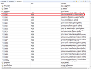

  • I transmit 5 uint16s over SPI from master(TMS320F28386D) to slave(TMS320F28377S).  0x0004, 0x0005, 0x0006, 0x0007, 0x0008.  I see 0x0004 in the MCBSP DRR1 of the slave.  However, nothing is copied over to my DMA rx buffer which is in global shared RAM.  Pics attached.
    If I set my slave BURST and TRANSFER to 1 I will get a DMA interrupt but no data is copied from DRR1 to RAM.
    I'm not sure why the DMA isn't doing the copy.  I'm going to try just transferring data from RAM to RAM using DMA on the TMS320F28377S just to make the DMA is configured correctly on the TMS320F28377S and I can narrow it down to something with MCBSP Slave/DMA. Let me know if you have any suggestions.  Thanks
  • Hello Nicholas,
    Yes, I think this would be a good thing to test out. There's actually a DMA example provided in C2000Ware for the F2837xS if you don't want to re-write a whole different project.
    Also, try changing your transfer size and burst count so that there is a single transfer of 5 bursts rather than 5 transfers of 1 burst. Let me know if you find out anything.

  • Hello Nicholas,
    1.  Can TI confirm 100% that using MCBSP SPI with DMA works on the TMS320F28377S?  Can we bubble this question up to someone who may know?
    I will bring this up with our design team to see if they can either reproduce this issue or confirm why it's happening.
    2.  If yes to question 1, can TI modify the C2000ware example mcbsp_ex6_spi_ext_loopback.c to use DMA?
    If they find an explanation for this, I will file a fix for this with the software team.
  • Thanks Omer, Any update on when to expect a response on this issue?
  • Hi Nicholas,
    There has been no update, I've emailed the design team already. I'll try to ping them again to try to get a response.
  • I got a response from the design team, it looks like they have a driverlib test case which is failing so they're currently looking into it. However, they did note that in the below line DRR1 should be DRR2:
    I'll follow-up once I got more updates.
  • Thanks, I will try with DRR2.  Based on the C2000Ware_4_00_00_00 mcbsp_ex2_loopback_dma.c I think DRR2 is for 32-bit transfers.  I'll try DRR2 and also try 32-bit transfers.  I have been using 16-bit transfers.
  • Okay, I have confirmed that the driverlib test case seems to be failing according to our validation team, I will be reaching out to the design expert and software expert to see what might be the reason for this.
  • Hi Nicholas,
    I confirmed with the software expert that the issue seemed to be caused by a configuration for DMA as a secondary controller for peripheral frame 2 was missing from the example. This fix has been filed and will update in the next release.
