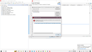

CCS told me the metadata of this demo: TI-DM-02000 cannot be interpreted.
How to fix this?

It's importing fine for me. I am using CCS 12.5, but that may not matter. Can you include a snapshot of the error you are seeing. Also, which example from the TIDM-02000 folder are you trying to import. There are two.

#2. My original problem is the DigitalPower SDK5.01.
I imported the 5.01 from this path: H:\TI\c2000\C2000Ware_DigitalPower_SDK_5_01_00_00\solutions\tidm_02000
And it gives me this metadata error screen.
How to fix it?

I am using DPSDK 5.01, same as you. I noticed you already have two PCMC projects in your workspace, maybe from when you imported TIDM-02000 from DPSDK4.03? You will need to either rename those projects or use a new CCS workspace to be able to import those same projects from DPSDK5.01.
I also checked with DPSDK folks, this is their feedback.
I do agree this appears to be an issue with the customers setup. I have not been able to replicate the issue described here. The fact that I see a non-projectspec project attempt to be imported tells me that there must be some modification on the user’s end.
Their path is mapped to their H: drive and perhaps they will need to add the path to their SDK installation under the Products window in CCS.

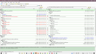

Hi Gus:
I think I can directly use the 4.0x version code.
I compared the diff between those 2, there are almost the same beside the version number in the code.
BR Rio
