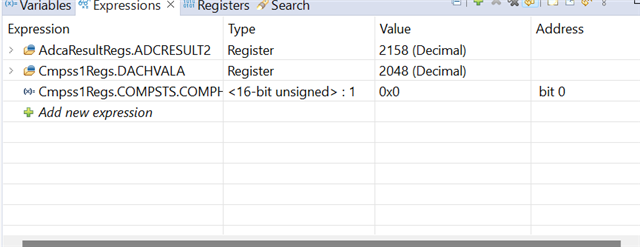

Hi , "cmpss_ex1_asynch" this example is not working as expected. I configured the ADC to check the value of Comparator input. The comparator output is not going HIGH even though the input is higherthan the DACHVALA.

Can you try to read the value of the voltage without activating the CMPSS module to see if the CMPSS influencing the ADC performance? for instance , apply 1,65 to pin and observe the result.
