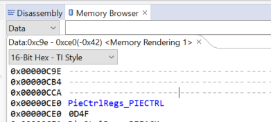

    I find that have instance of PIE_VECT_TABLE, but add it to the epressions, it cannot show the content
  • From the sequence, first register Interrupt_register(INT_NMI, &nmiISR);
    second register  Interrupt_register(INT_NMI, &TestISR);
    We use the test counter to test, that nmiISR has increased , but TestISR did not have increased counter.
    So I want to to confrim the actually handler for the INT_NMI
  • It is because that no usegae of instance(PieVectTable), after to use it, debugger epressions can show the content
  • Hi WZ,
    yes you are right. Since there is no usage of the instance, it would not have updated in the register view.
    I suggest you to check in the memory map for the PIEVECT location, or you can add it in the project properties to retain the value.
    Also it would rewrite the ISR handler if you are defining multiple ISR for the same interrupt (Will be taking the last added ISR handler).
    Aswin
  •  memory map for the PIEVECT location, does it mean that use debugger to view the memory window of specified address?
  • Yes, you can view the value using the memory browser window in CCS.
