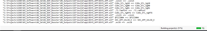

I am trying to add ECC on FLASH. I added commands in linker but when I do the build it remains stuck. Any idea what I am doing wrong?

Hello Vamsi,
we need to activate the ECC for the safety implementation.
Can you please recommend a document on how to use the AutoEccGeneration mode.
Thank you!
Hi Daniel,
TI's CCS On-chip flash plugin and UniFlash support AutoEccGeneration mode by default. You will notice a radio button for AutoEccGeneration in the GUIs of these tools - and it is enabled by default. When this is enabled, you don't need to do anything to generate/program the ECC for the main array - flash tools will program the ECC for you.
