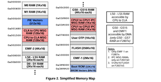

hello there,
I have a question regrading the memory map of TMS320F28379D \
1) why there is separate block M0,M1 and D0,D1 which have same role but different name ?
2)what are sections in the memory map which available to the user ?
3) in the below given image why they have used different colors and what is its significance ?
https://www.ti.com/lit/an/sprt720/sprt720.pdf?ts=1708136338055&ref_url=https%253A%252F%252Fwww.ti.com%252Ftool%252FLAUNCHXL-F28379D%253Futm_source%253Dgoogle%2526utm_medium%253Dcpc%2526utm_campaign%253Depd-c2x-null-44700045336317722_prodfolderdynamic-cpc-pf-google-soas_int%2526utm_content%253Dprodfolddynamic%2526ds_k%253DDYNAMIC%2BSEARCH%2BADS%2526DCM%253Dyes%2526gad_source%253D1%2526gclid%253DCjwKCAiArLyuBhA7EiwA-qo80DPpJAZAGJV_WywgvpynQTbbVOmSb3m0DCTiZphUslADBzDKs-6BXxoCjooQAvD_BwE%2526gclsrc%253Daw.ds
    I'm not overly familiar with this particular document, but based on what I can see it looks like all the gray blocks are "normal" memory (not particularly specialized, besides OTP), red is message RAMs (i.e. CPU to CLA or CPU to CPU), dark blue is the interrupt (PIE) vectors, and light blue is memory relating to boot ROM.
