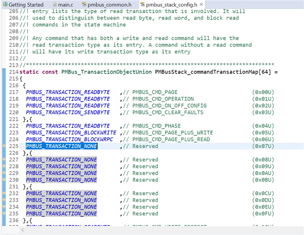

  • Hi Experts,
    When the slave device receives an invalid read command marked below "PMBUS_TRANSACTION_NONE", how to send NACK to host? Thanks.
  • Hello Shaoxing,
    Do we have any method to modify PMBus stack or add some workaround to avoid this?
    Has the customer tried modifying the PMBTIMLOWTIMOUT register? It looks like this would be the timeout value relating to when the clock is low for too long. The customer can try lowering the number of clock cycles in this register to see if this helps.
    It seems like the F28002x device is the controller in this situation and the target is what's sending the "PMBUS_TRANSACTION_NONE", is that correct? If so, there does not seem to be a way to manually ACK/NACK the specific command. The PMBSC register has a way of enabling manually acknowledging received command code, but this is specifically when configured in target mode.

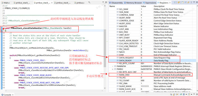

  • Hi Amir,
    Right. F28002x is the target slave device. We use PMBSC & MAN_CMD. So we can manually ACK/NACK the specific command.
    But the Data Request flag not yet set as below figure, only automatically set DATA_READY flag. So why the Data Request flag not yet set?
  • Hello Shaoxing,
    Per the register bit description for DATA_REQUEST and DATA_READY, it looks like the firmware needs to read the data before any other PMBus activity can take place. From what I see, the data needs to be read before the PMBus can request more data because the read buffer is currently full.
