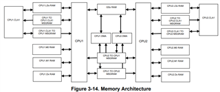

    At last, please let me comfirm one thing.
    I believe that the FLASHxx and RAMxx in Allocation Window are all belonging to CPU1, rignt?
    Thank you.
  • Hello Toshinori,
    It depends, for Flash and LSx RAM yes this is the case. For GSx RAM the controller for the memory can be either CPU1 or CPU2 as determined by the configuration in the GSxMSEL register.
