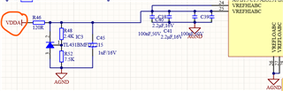

  • Hello Ibukun,
    As shown in Figure 1 below, the customer's voltage reference circuit, VDDA is 5V, and 3.3V is generated through the voltage regulator device to power the ADC external reference.
    In the experiment, the voltage waveforms of Pin24 and Pin25 were tested, and 3.3V was stable.
    Figure 1

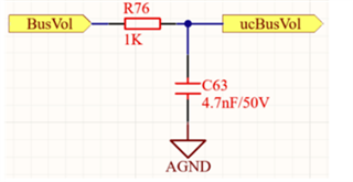

    Figure 2 below shows the customer's sampling network. Bus+ and Bus- are high voltages of about 800V. They are sent to the ADC port (ucBusVol) after voltage division and differential circuit conditioning. The measured signal is also stable.
    Figure 2

  • Hi Yale,
    Please see my comments below.
    Is VDDA supply and VDDIO supply generated from the same regulator?  When these supplies are ganged, switching noise from the digital logic may couple to the VREF line.  This could be a potential reason for the noise being observed.
    Figure 1 (input network) shows a string of 6 470k resistors (~2.8M series resistance per input).  I do not see any voltage divider though so it seems to be that the 800V goes directly to the ADC channels, which obviously is not correct.  Maybe there is a missing resistor going to ground that is not shown in the diagram?
    Regardless, the input network involves the use of high value resistors and capacitance that directly connects to the ADC inputs and this would require higher ACQPS because of this impedance for the ADC to properly sample the signal.  Can you check what ACQPS value that the customer is using?
    Sorry for the problem with the previous statement. Bus+ and Bus- directly enter the differential amplifier circuit without voltage division.
    The following figure shows the customer's ACQPS configuration. ACQPS = 10. All sampling channels are configured the same. Is there any problem with this configuration?

  • Hi Yale,
    What is not clear to me is how BUS VO+ and BUS VO- connects to the ADC input of the F280039.  Does it connect directly to BusVol node with the the 1K/4.7nF input network?
    I see that ACQPS uses the minimum value but with the RC impedances involved, acqps should be way higher.  Please see section 16.13.2 Choosing an Acquisition Window Duration of the TRM on how ACQPS is derived.  This would also impact accuracy of conversion.
    Joseph
  • Hi Joseph,
    The customer re-described their voltage sampling circuit: the two resistors R109 and R131 in the picture are not actually used. They are actually a simple differential amplification followed by two stages of RC filtering and sent to the MCU port. The voltage calculation formula after conditioning is:
    ucBusVol = R105/Sum(R98+R99+R100+R101+R102+R103+R106) * (Bus+ - Bus-)
    In addition, the customer read the description of ACQPS calculation in section 16.13.2 and has a question to ask.
    Do Rs and Cs in the figure below correspond to the last stage RC filter parameters in their circuits? That is, the parameters shown on the right.
    If so, they plug it into the formula to calculate, and the corresponding ACQPS should be 13. Currently, they set it to 10. It doesn't seem to be much different than what you said. Later they will change the ACQPS value to verify whether this is the problem. But they usually put multi-stage RC filtering in the sampling circuit. At this time, do Rs and Cs only consider the parameters of the level close to the MCU port?
    Thanks & Regards
  • Yale,
    It represents the equivalent RC of the entire input network, not just the components that are close to the pin. Assuming you treat the op amp as ideal with zero output impedance, the computation is on everything else after it.
    Ibukun
