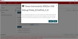

I'm trying to set-up a connection in CCS v 12.3 with the device TMS320F280034 using the XDS200 debug probe. Unfortunately I'm facing the following issues:
- Led green appears on XDS200
- When I click on Test connection I see the following error (I also checked the connection with xds2xx_conf):
[Start: Texas Instruments XDS2xx USB Debug Probe_0]
Execute the command:
%ccs_base%/common/uscif/dbgjtag -f %boarddatafile% -rv -o -S integrity
[Result]
-----[Print the board config pathname(s)]------------------------------------C:\Users\xxxx\AppData\Local\TEXASI~1\CCS\
ccs1230\0\0\BrdDat\testBoard.dat-----[Print the reset-command software log-file]-----------------------------
This utility has selected a 560/2xx-class product.
This utility will load the program 'xds2xxu.out'.
E_RPCENV_IO_ERROR(-6) No connection: DTC_IO_Open::dtc_io
Failed to open i/o connection (xds2xxu:0)An error occurred while soft opening the controller.
-----[An error has occurred and this utility has aborted]--------------------
This error is generated by TI's USCIF driver or utilities.
The value is '-250' (0xffffff06).
The title is 'SC_ERR_ECOM_EMUNAME'.The explanation is:
An attempt to access the debug probe via USCIF ECOM has failed.[End: Texas Instruments XDS2xx USB Debug Probe_0]
- Some days ago I was able to have a test connection working properly but with CCS v 12.6
- I uninstalled it since the CCS version was not correct
- The drivers in the PC seems also installed correctly:
Do you have any suggestion to solve it?
