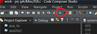

When flashing the program, sometime this issue occurs.
It's fine to flash another project using the same board, which means the debuggers is connected to the target.
And this project itself worked to be flashed before.
Comparing the configuration in properties -> debug -> program/load options, autorun and launch options, they are the same with the project which is find to flash.
And when testing the connection, the result is success:
After power cycling the board and reconnect the debugger and restart CCS, it doesn't help.
It happened before. I don't know how it worked later. This happens occasionally and I have no idea when it might happen.
Anyone has any idea on this issue? Or how to debug this issue?

    Thanks for the clarification, the debug button in CCS will do several steps automatically, launching the .ccxml, connecting the target, building the active project, loading the active project(including programming the flash), and typically running to "main".  If any of these steps has an issue the entire process will terminate.
    When this issue of connection occurs, it is typically because the device's Code Security Module is active, even if customer does not have password programmed, the device still comes up in a "locked" state.  If the device is executing from a secure memory region, and a debugger connection is attempted it will get blocked.  This is why I suggest trying wait boot mode, as it will keep the device in unsecure ROM so this cannot happen.
    Back to your case, I suspect this is why the issue is intermittent, it is dependent on where your code is executing from when the debugger attempts to connect.  This is also likely why if there is an issue, if you try again it works.
    If this is problematic, then we can "unlock" the device by embedding the below password match flow into your code so that the device will not be secure and the JTAG connection will never be blocked.
