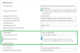

  • Naresh,
    For phase shift usage you need to:
    1. Enable phase shift mode by using API: EPWM_enablePhaseShiftLoad(EPWM_base address).
    2. Phase shift value entered in this API: EPWM_setPhaseShift(EPWM_base address, n) where "n" is in TBCLK steps.
    Before initializing EPWM there is a need of disabling TBCLKSYNC and after initializing there is a need of enabling TBCLKSYNC as follows but in the above code EPWM initialization is done in for loop.
    SysCtl_disablePeripheral(SYSCTL_PERIPH_CLK_TBCLKSYNC);
    initEPWM1();
    initEPWM2();
    initEPWM3();
    SysCtl_enablePeripheral(SYSCTL_PERIPH_CLK_TBCLKSYNC);
    If you want to update phase shift in for loop, you can enable phase shift at EPWM initialization for corresponding EPWM instance and phase shift value can be updated in for loop using API "EPWM_setPhaseShift".
    Shashank
  • Hi Naresh,
    my requirement is to change duty cycle of PWM based on change potentiometer of ADC ( kindly provide which ADC pin can i  use?)
    1. ADC Configurations are not seen in the code you have shared. I am hoping you have the ADC channel selected for SOCs in use. If not, please check the adc_soc_software example for the software force usage.
    2. Once you have the ADC SOC results (your potentiometer resutls), scale them as per your duty cycle requirements. E.g.
      1. The EPWM period is 1000, the ADC values range in from 0-4095.
      2. EPWM is up-down count mode
      3. output A is low on counter up and equals cmpA, and high on counter down and cmpA.
      4. therefore, your duty cycle with respect to cmpA is, (1000-cmpA+1)+(1000-cmpA) / 2*1000.
      5. you can update your calculated CMPA value by  `EPWM_setCounterCompareValue(EPWM1_BASE, EPWM_COUNTER_COMPARE_A, Mapped_adcAResult0);`
    which APIs can change phase shift of PWM wave.
    1. you can refer the epwm_synchronization  example for phase shift related coding. also the example uses sync mechanism between EPWMs, [also refer 15.4.3.3 Time-Base Counter Synchronization], for forcing, you might consider a gpio for the external trigger.
    2. without sync, you cannot have the phase shift usable. Also note that with the phase shift in the up-down count mode, you might have to configure the counter direction when sync event occurs. [image below for reference]
    thanks and regards,
    Madhava
