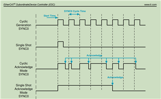

How to use EtherCAT to drive Sync/Latch output or capture pulses? Can you give me a way to use it?

Please see TRM Section 26.2.10.1 for information on the distributed clock feature. This is also a standard part of EtherCAT, so you may be able to find general information on the web.
