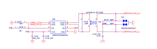

But I have custom board which is TMS320F28377D.  I am not  getting any  output when i tried to probe with Oscilloscope.
This is the transceiver circuit . I am using CAN B transmit .CAN_2_TX and CAN_2_RX are the pins coming from Controller.

  • Hey Hareesh Janakiraman!! I also have a similar issue. I am using the can_ex4_simple_transmit code from the examples for the launch-xl F28379D. I am using a Can Debugger from Kvaser CanKing to get the data from the MCU and i am able to get the data on the output window of the Kvaser CanKing software . I also have a F28377D-ep MCU on a custom board and i want to do the same on the custom board too. On the launch-xl board we have GPIO 12 and 17 connected to the j12 header as see below.
    I have GPIO 38 and 39 on my MCU connected to a transceiver as seen below.
    I have changed the GPIO 12 and 17 to GPIO 38 and 39 to test the same code on my custom board, but i am unsuccessful to do so.

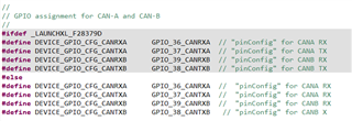

  • Refer to 4.1.1 How to Change the GPIO Assignment for the CAN Pins in SPRACE5. I have clearly explained the steps involved in changing the GPIO pins.
  • Hey Hareesh Janakiraman,
    I believe i have configured the GPIO Pins correctly according to 4.1.1,
     ---> in main.c
     --->in device.h
     ---> in pin_map.h
    Here is also the pin allocation from the MCU to CANTXB and CANRXB,
    Thanks & Regards,
    Denzil Rhodes.

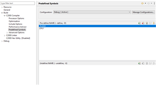

  • You need to remove the symbol _LAUNCHXL_F28379D from your project (everything under that #ifdef should appear greyed out).
  • Yes I have removed the symbol  _LAUNCHXL_F28379D  from my project.
