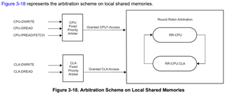

    If you're talking about access arbitration, this is described in section 3.12.1.7 Access Arbitration of the device reference manual. Blocking specifically is controlled by access protection, which determines which controller has access to the RAM in general (i.e. not a per-write/read operation).
    There will be no conflicts based on the above arbitration scheme when two writes are issued to the same RAM (in the worst case, a read will return stale data).
    If the above mentioned is true, I would further like to know if the blocking of the LSRAM affects the whole LSRAM or only the variable that the controller is writing on?
    The arbitration/protection is per RAM, not per address.

    Hence, my question was aimed at understanding if there exists independent Access Arbitration for LSRAM1 and LSRAM2.
    Yes, these two RAMs have separate access arbitration, the access arbitration is for each RAM not all RAM as a whole. If you treat each RAM as separate, then you should have no problem accessing the memory in the way you've described.
