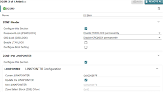

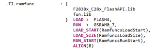

As shown in the figure below, GSRAM cannot be encrypted. When memcpy needs to be used to move part of the security FLASH code to GSRAM, if there is a need to call other code that is still in the FLASH security area and has not been moved to GSRAM code, It will cause an error that calls the code of the security zone in the non-security zone, so that the program cannot run normally. The best solution, of course, is to replace the GSRAM that carries the code to the destination with LSRAM that can be encrypted, but if the amount of code that needs to be carried to RAM is large, LSRAM alone cannot be loaded, how to solve the problem? In order to avoid calling the code of the secure area in the non-secure area, can only use LSRAM as the transport destination, and the storage of larger GSRAM can only store variables and other data, can not be used as the code running space?
memory map
sysconfig DCSM
CMD

    Any functions that do not directly read or write to secure resources could be placed in GSRAM. These functions could still call other functions that need to access secure resources, so move as many of these child functions to LSRAM as possible. You're correct that only LSRAM can be secured while GSRAM is always unsecure. The amount of LSRAM is finite so you may have to reduce the length of some functions or place them in FLASH in order to fit all of your code into available securable memory.

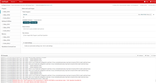

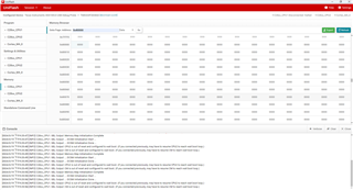

  • Your description of Uniflash does not seem to be consistent with the phenomena I experimented with. With DCSM enabled and the main function starting to call DCSM_unlockZone1CSM to unlock, the program works normally and the LED blinks normally. If Uniflash is connected to JTAG to read the memory at this time, the read back is indeed all zeros, and it is observed that the LED does not blink at this time, the program is not running, and the chip is suspected to be in the wait boot state.
    Similarly, using Uniflash to download a program without unlocking it by typing CSMPSW in Uniflash will also fail. Does this mean that even if the main function starts calling DCSM_unlockZone1CSM, the code is still safe? Without knowing the password, the hacker can neither access the chip memory through Uniflash nor write his own code to read back the memory data using the communication peripherals. Of course, the user's own code does not provide a way to access all of the chip's memory through the communication peripherals.

  • As you said, after calling DCSM_unlockZone1CSM, the hacker can read any memory location through the JTAG connection. But my actual test results tell me that in this case, the chip memory read back by UniFlash tool is still zero, may I ask what is wrong with my operation?
  • Hi Weiquan,
    One of three things is happening here:
    1. DCSM_unlockZone1CSM is unsuccessful
    2. The device is being reset by Uniflash when you attempt to read from the memory browser, which relocks the zone
    3. DCSM_unlockZone1CSM has not been called yet when you attempt to read from the memory browser.
    Can you confirm 1 and 3 are not happening? If so, I believe this is an issue with Uniflash. It is either resetting the device and re-locking the zone or some other issue with Uniflash is causing all 0s to show up. I will loop in a Uniflash expert to explain this if you can confirm 1 and 3 are not occurring.

  • 1. When JTAG is not used to connect the chip, DCSM_unlockZone1CSM must be called successfully, otherwise my code will not run properly due to the problem of accessing the secure area from the non-secure area.
    2. When Uniflash is used to read or download programs to the chip, I suspect that as you said, the chip will be reset and stay in BootROM without executing DCSM_unlockZone1CSM in my code, so reading memory or downloading programs will fail. The program stays in BootROM judging that my LED is not blinking.
    Based on the above two points, can I confirm that even if I call DCSM_unlockZone1CSM in my code, the hacker will not be able to access chip memory from UniFlash?
