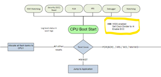

  • Hi Vivek,
         In TRM4.5.1 Boot Flow - Figure 4-1 Device Boot Flow, I didn't understand the description : "HW: WDG enabled Set Clock Divider to /4 Enable ECC". Is this description about Hardware layout ?
         Can you explan this description? Maybe this is the key to solve this issue.
    B.R.
    Bolt
  • That statement is about some of the action taken by BOOTCODE and nothing to do with board layout.
