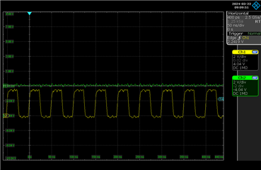

The actual hardware signals look good. The following recording refers to signals in the real application with valid current values. So this is not part of the example recordings above. Here is a recording of clock and data to SDFM2 before they enter the CPU.
The SDFM units are set as follows:
  • SDFM Clock 20MHz
  • Sinc3 Filter
  • OSR 256
  • 16 bit format
  • Sync of the filter and the FIFO with PWM16 SOCB controlled via CPU1
What can I do to ensure that the SDFM2 unit delivers correct values?
