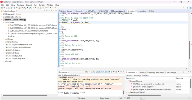

i am working on F28379D and current working on read and write operation for SD card while working i encounter an issue with the program where i facing error while using f_mount  first i used fresult = f_mount(0, &fs); while using this i encountered the following error
Descrip
 * main.c

tion Resource Path Location Type
#167 too few arguments in function call main.c /sdcard line 40 C/C++ Problem
Description Resource Path Location Type
gmake: *** [main.obj] Error 1 sdcard C/C++ Problem
gmake: Target 'all' not remade because of errors. sdcard C/C++ Problem
so after i read the f_mount declaration which is FRESULT f_mount (FATFS* fs, const TCHAR* path, BYTE opt); /* Mount/Unmount a logical drive */  and after i programed the device as the following fresult = f_mount(&fs,"",0);

  • Hello Siva,
    Based on your Problems window, it looks like you have 2 types of errors. The first one is that the program will not fit into available memory; for this you will need to double-click the row to see which section of your linker command file needs more memory allocated to it and make the proper adjustment.
    The second error is for unresolved symbols. You can go to the file where the symbol is located and verify that the proper header file or declaration is made within the scope of the file itself. If you do CTRL + Click on the variable/function, it should lead you to the proper declaration if configured correctly (if it points to an extern declaration, you will need to make sure to declare the variable somewhere as the extern simply states that the function is to be declared elsewhere).
    Let me know if you still have errors beyond this.
