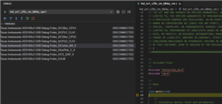

  • After setting up a debug configuration, in eclipse there is a tab (first one) where you can select the cores that you want to debug in the session, in theia this tab is not present.
    Another thing, when I debug in Theia: CPU1 I see the software in CM running, when I debug CM, CPU1 does nothing, thus CM not blinking LEDS as expected, (seems to not have control on gpio pins).
  • Hi Frenk,
    In CCS Theia, there are a few changes to see CM.
    1. In the Debug tab on the left of Theia, you might see only CPU1 and CPU2.
    However, if you right click -> show all cores
    You should be able to see now all the other options such as CM (Cortex_M4)
    2. Next make sure to connect target to CPU1 and Cortex M4.
    3. Load the individual programs to CPU1 / CM respectively
    You should now be able to select between C28xx_CPU1 and Cortex_M4_0 to debug.
    Ryan Ma
