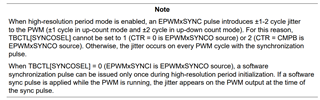

I am using a C2000 microcontroller to generate a HRPWM signal (2-10 MHz, using channels A and B, including deadband control) with a constant 50% duty cycle. This works fine in up-down-count mode with HR period control and HR COMPA and COMPB registers.

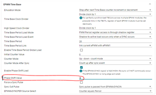

Now I want to add a second PWM (ePWM2), synchronized to the first. I want to add a phase shift between these two signals. If I understand correctly, there is no way to do this with high resolution since I am using high resolution for the compare registers. But this is fine for me.
However, even without the high resolution phase shift, I cannot get the synchronization to work correctly: Using sysconfig in CCS, I configured ePWM1 to send a sync-out pulse when the timebase counter equals zero. As I understand it, ePWM2 should now synchronize, but it does not when I enable HRPWM for the HR period control and compare registers.
I have also noticed that PWM2 does not synchronize when I disable the phase shift load. Why does this happen?
I have created a new project based on the example "epwm_ex3_synchronization" from C2000Ware. This minimal test project is attached: In the .syscfg file you can see how I did the configuration that causes the erroneous behavior I described above.  I suspect that I just did a configuration error, but I cannot find the error.

epwm2.hrpwm_phaseLoadEnable                                      = true;
epwm2.epwmTimebase_syncOutPulseMode                              = "EPWM_SYNC_OUT_PULSE_ON_EPWMxSYNCIN";
epwm2.epwmTimebase_periodLink                                    = "EPWM_LINK_WITH_EPWM_1";
epwm2.epwmCounterCompare_cmpALink                                = "EPWM_LINK_WITH_EPWM_1";
epwm2.epwmCounterCompare_cmpBLink                                = "EPWM_LINK_WITH_EPWM_1";
epwm2.hrpwm_enable                                               = true;
epwm2.hrpwm_autoConv                                             = true;
epwm2.epwmTimebase_periodLoadEvent                               = "EPWM_SHADOW_LOAD_MODE_SYNC";
epwm2.epwmTimebase_phaseEnable                                   = true;
epwm2.epwmTimebase_phaseShift                                    = 3;

    HRPWM_enablePhaseShiftLoad(myEPWM2_BASE);
    HRPWM_setPhaseShift(myEPWM2_BASE, 3);
    HRPWM_setSyncOutPulseMode(myEPWM2_BASE, EPWM_SYNC_OUT_PULSE_ON_EPWMxSYNCIN);

  • Hi Allison,
    Thanks for your reply! The mentioned section 18.15.1.5.4.1 was very helpful in showing the limits of HR period control in combination with synchronization. I understand it to mean that I cannot synchronize the two PWMs in every period, but I assume that I can do a synchronization with a software pulse, e.g. after changing the period.
    I have tried to implement software pulse synchronization in a simple example with HR period control: ePWM1 is in free run emulation mode while ePWM2 stops during debugging. When I pause the program in debug mode and resume it after a short while, the two PWM signals are randomly shifted.
    Now, I would expect both signals to get synchronized again after one second, since I am generating a software pulse in the main loop every second. But unfortunately the signals do not get synchronized.
    So I am still doing it wrong somehow. If I disable the HR period control, the software pulse synchronization works fine.
    I would really appreciate it if you could take another look at my configuration. Just for your information: I did this basic example without the sfo-lib, but I think this should have no effect on the software sync.
    Cheers,
    Jonathan

    epwm1.epwmTimebase_counterModeAfterSync                          = "EPWM_COUNT_MODE_UP_AFTER_SYNC";
    epwm1.epwmTimebase_syncOutPulseMode                              = "EPWM_SYNC_OUT_PULSE_ON_EPWMxSYNCIN";
    epwm1.epwmTimebase_phaseEnable                                   = true;
    epwm1.epwmTimebase_phaseShift                                    = 3;
    epwm1.epwmTimebase_periodLoadEvent                               = "EPWM_SHADOW_LOAD_MODE_COUNTER_SYNC";

    epwm2.epwmTimebase_counterModeAfterSync                          = "EPWM_COUNT_MODE_UP_AFTER_SYNC";

  • Hi Jonathan,
    This was also discussed and answered in another thread (see the link for other context on this thread):
    "HRPWM synchronization requires a very specific process. So you definitely don't want to send a SYNCO from the parent EPWM to the child EPWM on EVERY CTR=ZERO or CTR=PRD event. What you want to do is do ONE SWSYNC pulse at the time of initialization. In doing so ONLY the first cycle of your two in phase EPWM may have a jitter but for the rest of the cycles there won't be jitter.
    IF you need to resync with a new PHASE SHIFT, you will set the new phase shift value, and then ONLY ONCE you SEND a SWSYNC. Again, on the first cycle of the new phase shift you may have jitter, but on all following cycles, you should be good, without jitter and with the new PHASE."
    In terms of your case, the synchronization should still work but as mentioned in the answer above. Have you also already been able to get a non-HR phase shift to work properly? There are examples (such as EPWM driverlib example 3) in the C2000ware SDK that you can try out to reference. Let me know if you are able to do so and compare PWM settings.
    Allison
  • Hi Allison,
    Actually, the code I sent you above was based on the C2000ware example. So I was able to get a non-HR PWM to work properly with a given phase shift.
    And finally I also found the problem when using HRPWM: The "Phase Shift Value" I enter in the syscfg GUI (highlighted in red in the screenshot) is not processed when HRPWM is active. So the entered value is not passed to TBPHS within the auto-generated code. The sysconfig GUI is misleading in this case.
    I solved this problem by using the following driverlib function instead of sysconfig.
    void HRPWM_setPhaseShift(uint32_t base, uint32_t phaseCount)
    Thanks for your support.
