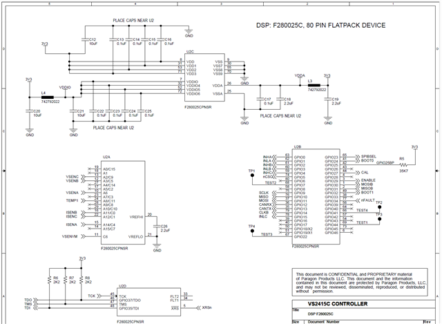

TMS320F280025C: new design from Launchf280025c evm. F280025c at 2.4 v of 3.3V power supply rising causes rising excessive current after that V point
Part Number: TMS320F280025C
F280025C new design from launchpad evm previous 3 years of successful work. 5 first articles are being tested.
F280025C  80pin version,  startup with only bootloader, no code s/b in new DSP?
1. all 80 pins have no shorts to ground and correct 3.3 connections
2.  VDDIO and VDDA are laid out like the launch pad.  the two inductors (0.05 ohms) show now voltage drop when excessive current is at ~330ma (PS is current limited)
3.  VREFHI is directly connected to 3.3 VDD and it is assumed that this is the default acceptable reference connection since internal references not enabled.
4.  JTAG XDS110 cannot access because  DSP asserts XRSn continuously, OS slow power up -> rises to 0.8 and then down to 0.2 as expected, but never releases.  No other XRSn attached at this time
5. All traces and Gerbers look good for no shorts.
6.  F280025CPNS DSP code  $7A-34C8K5W.  a 64 is below that line
7  one possibility is that an internal starup and/or bootloader fault is a cause?
8  boot is to Flash  1,1.
a second PCB does the same thing.
This is driving a DRV8323RS 3 phase motor circuit, BUT NOT CONNECTED FOR THIS ISSUE.

    Would it be possible for you to scope the VDD/VDDIO and XRSn pin and send the snapshot ?

  • Thanks for the snapshot. Power supply looks ok. If you have not programmed anything in flash and boot mode is set to 1'1 then device may get reset because of ITRAP. Can you try changing the bootmode pin to some other value and see if that helps ?

  • finally found how to continue.  Not resolved.  2.4V increasing voltage has increasing current from 34 ma to 500 ma at 2.6 V where my PS current limits.  set to SCI no difference.
    XRSn stays at 0.3 V+- with no other connections on the XRSn circuit (i.e. XDS110 not connected)

  • Will you be ok to share your board schematic ?
  • Yes, I'll be glad to.  thank you for asking.   I'll upload tomorrow by noon. (thursday 4/11)
    please note that the same problem exists with and without the 8323RS 3v3 power supply hooked up.  right now I've removed the inductor for the 3v3.  24V applied to the 8323 side is about 2 ma,  and the 3v3 separate supply is the run away with either 8323RS 3v3 or external.

    Again I've been testing with external 3v3 to isolate the issue in this area.  no excessive current in the 24V 8323RS area and I've removed the inductor for the 3v3 to isolate.  Same results with or without 8323RS 3v3 or isolated external 3v3.

  • Thanks. We'll have a look and get back to you. I'll also request you to re-check the signal integrity on the board for any potential issue.

    One quick observation. In this schematic, you are connecting all VDD signals to 3V3 rail instead of 1V2. This will definitely cause issue so please fix this.
    Vivek Singh
  • thank you !!  I'll change/test immediately.  Sorry about my ignorance about the internal supply.  I really appreciate your time because I was not seeing this issue.   Much appreciated.
    I'll mark resolved.
