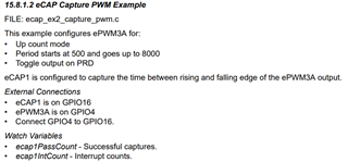

    Yes that is possible using the eCAP module capture mode on device
    You can route the external pwm signal on GPIO and then route it to eCAP module using Inputxbar
    Can also refer to c2000ware example 2
    Thanks!

    Try out a few of our examples that capture a single PWM waveform using eCAP. Once you understand this example, and where the input is coming from you could have an ISR that can change which input source the eCAP is monitoring. I would set up the eCAP to be in one shot mode so that a reArm is necessary to start a capture of the signal again when you're ready to capture after switching the input to eCAP to be from another input. If it was in continuous mode, it will not work trying to switch the input and then clear the captured events.
