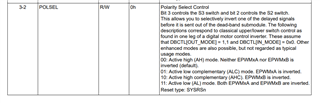

    Another thought is you could also try leveraging the deadband module to invert your signal using DBCTL.POLSEL:
    I'll keep you updated, but let me know if this is of interest as well.
    Allison
  • Hi Allison,
    I'm currently using the deadband module to invert the secondary signal (whilst also adding a deadband), but this has the side effect of having the B signal high at standby (using software force A low), which is what I'm trying to avoid. If there's a way to achieve an active high complementary output but also have the ability do keep both signals low, then this is what I'm looking for.
