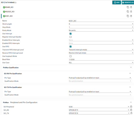

  • Hi Allison,
    Thank you for your reply.
    The current SCID setup is sysconfig as shown in the picture,  and the function I sent you before.
    When we used SCIC in the past, we used only sysconfig to set it up, and the PinMux in the picture is set to SCIC.
    In other words, the difference when changing from SCIC to SCID is the PinMux configuration and,
    only the added functions.
    I can't find any reason why I can't change the baud rate from 115200 bps to 2.5 Mbps.
    Is there any cause for this?
    Ito
  • Hi Ito,
    Do you mean when you try to type 2.5Mbps into the sysconfig baud rate, it doesn't let you? Or just that you are seeing the incorrect SCI rate output?
    Can you check the registers (using register view window in CCS with continuous refresh on) and/or check the sysconfig generated code (using the <> arrows in the upper right hand corner and looking at board.c) to see if the LOSPCP divider (for LSPCLK which is the clock source for SCI) and SCI baud rate register values are as expected?
    Allison
  • Hi Allison,
    No, the default setting in sysconfig is 115200 bps.
    After that, I set it to 2.5 Mbps with the function I sent you before.
    When I was using the SCIC module, I set the baud rate to 115200 bps in sysconfig and did not change the baud rate after that.
    This is my customer's code and I will check it as soon as I receive it.
    Ito
