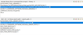

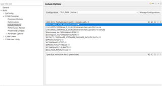

> then i include the file path in 'Build settings -> c2000 compiler -> include options

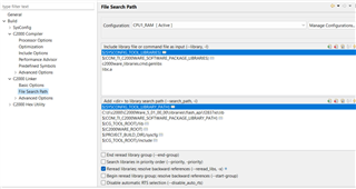

> then i also include library path in c2000 linker -> file search path

  • Hi Muzammil,
    When comparing the screenshots of your project build settings with the build settings of the flash programming example, there are a few differences to note.
    • In the "Include Options" view of the C2000 Compiler, you should be including the Flash API filepath: C2000Ware_Install_Location\libraries\flash_api\f2837xs\include
    • In the "File Search Path" view of the C2000 Linker, you should add the C2000Ware_Install_Location\libraries\flash_api\f2837xs\lib filepath
    • You don't need to create the Flash API folder in the "device" folder
    • Note: The "../" you see in the filepaths of the flash programming examples are indicating to move "up", or to the parent directory, of that relative location. For example: Path_A/Path_B/Path_C/../../ would result in the final path being Path_A/. Hopefully this clears up any confusion about how the flash programming example includes paths/libraries.

    Can you send an updated image of your project structure and the filepaths included? I am unable to recreate this error on my side.
    I am including these Flash API paths in my project and am able to compile with #include <F021_F2837xS_C28x.h> in my main file.
    Kind regards,

    Can you try adding the F021_API_F2837xS_FPU32.lib file to your project directory? Right click the project, select Add Files, navigate to C2000Ware_Install_Location\libraries\flash_api\f2837xs\lib, and select F021_API_F2837xS_FPU32.lib.
    Kind regards,
    Skyler

    this is my linker file.
    if i add the below code in the above file (at bottom, after the #endif), the error is solved but i am not able to write or read the flash.
    GROUP
    .TI.ramfunc
    { -l F021_API_F2837xS_FPU32_EABI.lib}
    } LOAD = FLASH_USED,
    RUN = RAMGS11,
    LOAD_START(RamfuncsLoadStart),
    LOAD_SIZE(RamfuncsLoadSize),
    LOAD_END(RamfuncsLoadEnd),
    RUN_START(RamfuncsRunStart),
    RUN_SIZE(RamfuncsRunSize),
    RUN_END(RamfuncsRunEnd),
    ALIGN(8)
    please guide me further.
