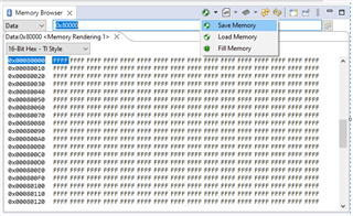

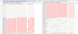

Tha Bootloader/ kernel is programmed using CCS, after every power reset, the bootloader/kernel code starts executing at the default flash address 0x80000 and looks for the key 0x5A5A5A5A stored in the end of the third sector. If the kernel finds the key, then it assumes that the Application is programmed already into the flash, and it calls the entry address of the application code as asm(" LB 0x00088000").
IF the kernel does not find the key, then it assumes that no Application code is present in the flash memory and it waits for user input to programmer the application code into the flash memory, after the programming it writes KEY value 0x5A5A5A5A into the end of kernel flash sector.

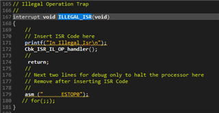

Here the Problem we are getting is , Once the kernel finds the key and calls the application using assembly instruction "asm(" LB 0x00088000")" , the code is not getting executed and staying at the reset vector.

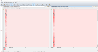

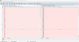

Here I have verified about the memory regions allocated and the generated after compiling I didn’t find any issue and there is no overlapping between kernel and the Application.
So, requesting to please suggest any way to resolve this, your help will be appreciated lot.

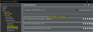

The memory partition is as below.

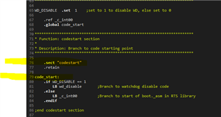

Bootloader code ---------------------- #pragma CODE_SECTION(bankSelect, "codestart"); void bankSelect(void) { if((HWREG((uint32_t)B0_KEY_ADD) != (uint32_t)KEY)) { CPU1_Kernel(); } else { // // Branch to 0x00088000; the codestart of bank 0 is // located at 0x00088000, which is a flash alt. entry point // asm(" LB 0x00088000"); } } bootloader memory configuration .cmd file -------------------------------------------- // Keep the _bankSelect symbol // -u bankSelect MEMORY { /* BEGIN is used for the "boot to Flash" bootloader mode */ BEGIN : origin = 0x080000, length = 0x000100 BOOT_RSVD : origin = 0x000002, length = 0x0001AF /* Part of M0, BOOT rom will use this for stack */ RAMM0 : origin = 0x0001B1, length = 0x00024F RAMM1 : origin = 0x000400, length = 0x0003F8 /* on-chip RAM block M1 */ RAMM1_RSVD : origin = 0x0007F8, length = 0x000008 /* Reserve and do not use for code as per the errata advisory "Memory: Prefetching Beyond Valid Memory" */ RAMD0 : origin = 0x00C000, length = 0x000800 RAMD1 : origin = 0x00C800, length = 0x000800 //RAMD01 : origin = 0x00C000, length = 0x001000 RAMLS0 : origin = 0x008000, length = 0x000800 RAMLS1 : origin = 0x008800, length = 0x000800 RAMLS2 : origin = 0x009000, length = 0x000800 RAMLS3 : origin = 0x009800, length = 0x000800 RAMLS4 : origin = 0x00A000, length = 0x000800 RAMLS5 : origin = 0x00A800, length = 0x000800 RAMLS6 : origin = 0x00B000, length = 0x000800 RAMLS7 : origin = 0x00B800, length = 0x000800 RAMGS0 : origin = 0x00D000, length = 0x001000 RAMGS1 : origin = 0x00E000, length = 0x001000 RAMGS2 : origin = 0x00F000, length = 0x001000 RAMGS3 : origin = 0x010000, length = 0x001000 RAMGS4 : origin = 0x011000, length = 0x001000 RAMGS5 : origin = 0x012000, length = 0x001000 RAMGS6 : origin = 0x013000, length = 0x001000 RAMGS7 : origin = 0x014000, length = 0x001000 RAMGS8 : origin = 0x015000, length = 0x001000 RAMGS9 : origin = 0x016000, length = 0x001000 RAMGS10 : origin = 0x017000, length = 0x001000 RAMGS11 : origin = 0x018000, length = 0x001000 RAMGS12 : origin = 0x019000, length = 0x001000 RAMGS13 : origin = 0x01A000, length = 0x001000 RAMGS14 : origin = 0x01B000, length = 0x001000 RAMGS15 : origin = 0x01C000, length = 0x000FF8 // RAMGS15_RSVD : origin = 0x01CFF8, length = 0x000008 /* Reserve and do not use for code as per the errata advisory "Memory: Prefetching Beyond Valid Memory" */ /* Flash sectors */ IPC_FLASH_MY : origin = 0x080100, length = 0x000100 /* on-chip Flash */ FLASH0 : origin = 0x080200, length = 0x001E00 /* on-chip Flash */ FLASH1 : origin = 0x082000, length = 0x002000 /* on-chip Flash */ FLASH2 : origin = 0x084000, length = 0x002000 /* on-chip Flash */ FLASH3 : origin = 0x086000, length = 0x002000 /* on-chip Flash */ FLASH4 : origin = 0x088000, length = 0x008000 /* on-chip Flash */ FLASH5 : origin = 0x090000, length = 0x008000 /* on-chip Flash */ FLASH6 : origin = 0x098000, length = 0x008000 /* on-chip Flash */ FLASH7 : origin = 0x0A0000, length = 0x008000 /* on-chip Flash */ FLASH8 : origin = 0x0A8000, length = 0x008000 /* on-chip Flash */ FLASH9 : origin = 0x0B0000, length = 0x008000 /* on-chip Flash */ FLASH10 : origin = 0x0B8000, length = 0x002000 /* on-chip Flash */ FLASH11 : origin = 0x0BA000, length = 0x002000 /* on-chip Flash */ FLASH12 : origin = 0x0BC000, length = 0x002000 /* on-chip Flash */ FLASH13 : origin = 0x0BE000, length = 0x001FF0 /* on-chip Flash */ // FLASH13_RSVD : origin = 0x0BFFF0, length = 0x000010 /* Reserve and do not use for code as per the errata advisory "Memory: Prefetching Beyond Valid Memory" */ CPU1TOCPU2RAM : origin = 0x03A000, length = 0x000800 CPU2TOCPU1RAM : origin = 0x03B000, length = 0x000800 CPUTOCMRAM : origin = 0x039000, length = 0x000800 CMTOCPURAM : origin = 0x038000, length = 0x000800 CANA_MSG_RAM : origin = 0x049000, length = 0x000800 CANB_MSG_RAM : origin = 0x04B000, length = 0x000800 RESET : origin = 0x3FFFC0, length = 0x000002 } SECTIONS { codestart : > BEGIN, ALIGN(8) .text : >> FLASH0 | FLASH1, ALIGN(8) .cinit : > FLASH1, ALIGN(8) .switch : > FLASH5, ALIGN(8) .reset : > RESET, TYPE = DSECT /* not used, */ .stack : > RAMD0 #if defined(__TI_EABI__) .init_array : > FLASH1, ALIGN(8) .bss : > RAMLS5 .bss:output : > RAMLS5 .bss:cio : > RAMLS5 .data : > RAMLS5 .sysmem : > RAMLS5 /* Initalized sections go in Flash */ .const : > FLASH1, ALIGN(8) #else .pinit : > FLASH1, ALIGN(8) .ebss : > RAMLS5 .esysmem : > RAMLS5 .cio : > RAMLS5 /* Initalized sections go in Flash */ .econst : >> FLASH1 , ALIGN(8) #endif ramgs0 : > RAMGS0, type=NOINIT ramgs1 : > RAMGS1, type=NOINIT MSGRAM_CPU1_TO_CPU2 : > CPU1TOCPU2RAM, type=NOINIT MSGRAM_CPU2_TO_CPU1 : > CPU2TOCPU1RAM, type=NOINIT MSGRAM_CPU_TO_CM : > CPUTOCMRAM, type=NOINIT MSGRAM_CM_TO_CPU : > CMTOCPURAM, type=NOINIT /* The following section definition are for SDFM examples */ Filter_RegsFile : > RAMGS0 Filter1_RegsFile : > RAMGS1, fill=0x1111 Filter2_RegsFile : > RAMGS2, fill=0x2222 Filter3_RegsFile : > RAMGS3, fill=0x3333 Filter4_RegsFile : > RAMGS4, fill=0x4444 Difference_RegsFile : >RAMGS5, fill=0x3333 #if defined(__TI_EABI__) .TI.ramfunc : {} LOAD = FLASH0, RUN = RAMLS0|RAMLS1|RAMLS2|RAMLS3, LOAD_START(RamfuncsLoadStart), LOAD_SIZE(RamfuncsLoadSize), LOAD_END(RamfuncsLoadEnd), RUN_START(RamfuncsRunStart), RUN_SIZE(RamfuncsRunSize), RUN_END(RamfuncsRunEnd), ALIGN(8) #else .TI.ramfunc : {} LOAD = FLASH0, RUN = RAMLS0|RAMLS1|RAMLS2|RAMLS3, LOAD_START(_RamfuncsLoadStart), LOAD_SIZE(_RamfuncsLoadSize), LOAD_END(_RamfuncsLoadEnd), RUN_START(_RamfuncsRunStart), RUN_SIZE(_RamfuncsRunSize), RUN_END(_RamfuncsRunEnd), ALIGN(8) #endif IPC_BANK0 : > IPC_FLASH_MY, PAGE = 0, ALIGN(8) } /* //=========================================================================== // End of file. //=========================================================================== */ Application memory configuration .cmd file -------------------------------------------- MEMORY { /* BEGIN is used for the "boot to Flash" bootloader mode */ BEGIN : origin = 0x088000, length = 0x000002 BOOT_RSVD : origin = 0x000002, length = 0x0001AF /* Part of M0, BOOT rom will use this for stack */ RAMM01 : origin = 0x0001B1, length = 0x000647 // RAMM0 : origin = 0x0001B1, length = 0x00024F // RAMM1 : origin = 0x000400, length = 0x0003F8 /* on-chip RAM block M1 */ // RAMM1_RSVD : origin = 0x0007F8, length = 0x000008 /* Reserve and do not use for code as per the errata advisory "Memory: Prefetching Beyond Valid Memory" */ RAMD0 : origin = 0x00C000, length = 0x000800 RAMD1 : origin = 0x00C800, length = 0x000800 //RAMLS0 : origin = 0x008000, length = 0x000800 //RAMLS1 : origin = 0x008800, length = 0x000800 RAMLS0LS1 : origin = 0x008000, length = 0x001000 RAMLS2 : origin = 0x009000, length = 0x000800 RAMLS3 : origin = 0x009800, length = 0x000800 RAMLS4 : origin = 0x00A000, length = 0x000800 RAMLS5 : origin = 0x00A800, length = 0x000800 RAMLS6 : origin = 0x00B000, length = 0x000800 RAMLS7 : origin = 0x00B800, length = 0x000800 RAMGS0 : origin = 0x00D000, length = 0x001000 RAMGS1 : origin = 0x00E000, length = 0x001000 RAMGS2 : origin = 0x00F000, length = 0x001000 RAMGS3 : origin = 0x010000, length = 0x001000 RAMGS4 : origin = 0x011000, length = 0x001000 RAMGS5 : origin = 0x012000, length = 0x001000 RAMGS6 : origin = 0x013000, length = 0x001000 RAMGS7 : origin = 0x014000, length = 0x001000 RAMGS8 : origin = 0x015000, length = 0x001000 RAMGS9 : origin = 0x016000, length = 0x001000 RAMGS10 : origin = 0x017000, length = 0x001000 RAMGS11 : origin = 0x018000, length = 0x001000 RAMGS12 : origin = 0x019000, length = 0x001000 RAMGS13 : origin = 0x01A000, length = 0x001000 RAMGS14 : origin = 0x01B000, length = 0x001000 RAMGS15 : origin = 0x01C000, length = 0x000FF8 // RAMGS15_RSVD : origin = 0x01CFF8, length = 0x000008 /* Reserve and do not use for code as per the errata advisory "Memory: Prefetching Beyond Valid Memory" */ /* Flash sectors */ FLASH0 : origin = 0x080000, length = 0x002000 /* on-chip Flash */ FLASH1 : origin = 0x082000, length = 0x002000 /* on-chip Flash */ FLASH2 : origin = 0x084000, length = 0x002000 /* on-chip Flash */ FLASH3 : origin = 0x086000, length = 0x002000 /* on-chip Flash */ BTDC_APP_FLASH : origin = 0x088050, length = 0x001000 FLASH4 : origin = 0x089050, length = 0x006FB0 /* on-chip Flash */ FLASH5 : origin = 0x090000, length = 0x008000 /* on-chip Flash */ FLASH6 : origin = 0x098000, length = 0x008000 /* on-chip Flash */ FLASH7 : origin = 0x0A0000, length = 0x008000 /* on-chip Flash */ FLASH8 : origin = 0x0A8000, length = 0x008000 /* on-chip Flash */ FLASH9 : origin = 0x0B0000, length = 0x008000 /* on-chip Flash */ FLASH10 : origin = 0x0B8000, length = 0x002000 /* on-chip Flash */ FLASH11 : origin = 0x0BA000, length = 0x002000 /* on-chip Flash */ FLASH12 : origin = 0x0BC000, length = 0x002000 /* on-chip Flash */ FLASH13 : origin = 0x0BE000, length = 0x001FF0 /* on-chip Flash */ // FLASH13_RSVD : origin = 0x0BFFF0, length = 0x000010 /* Reserve and do not use for code as per the errata advisory "Memory: Prefetching Beyond Valid Memory" */ CPU1TOCPU2RAM : origin = 0x03A000, length = 0x000800 CPU2TOCPU1RAM : origin = 0x03B000, length = 0x000800 CPUTOCMRAM : origin = 0x039000, length = 0x000800 CMTOCPURAM : origin = 0x038000, length = 0x000800 CANA_MSG_RAM : origin = 0x049000, length = 0x000800 CANB_MSG_RAM : origin = 0x04B000, length = 0x000800 RESET : origin = 0x3FFFC0, length = 0x000002 } SECTIONS { codestart : > BEGIN, ALIGN(8) .text : >> FLASH4 | FLASH5 | FLASH6 | FLASH7, ALIGN(8) .cinit : > FLASH5, ALIGN(8) .switch : > FLASH5, ALIGN(8) .reset : > RESET, TYPE = DSECT /* not used, */ //.stack : > RAMLS0LS1 .stack : > RAMD0 #if defined(__TI_EABI__) .init_array : > FLASH9, ALIGN(8) .bss : > RAMD1 .bss:output : > RAMD1 .bss:cio : > RAMD1 .data : > RAMD1 .sysmem : > RAMD1 /* Initalized sections go in Flash */ .const : > FLASH6, ALIGN(8) #else .pinit : > FLASH6, ALIGN(8) .ebss : > RAMD1 .esysmem : > RAMD1 .cio : > RAMD1 /* Initalized sections go in Flash */ .econst : >> FLASH6 | FLASH7, ALIGN(8) #endif ramgs0 : > RAMGS0, type=NOINIT ramgs1 : > RAMGS1, type=NOINIT MSGRAM_CPU1_TO_CPU2 : > CPU1TOCPU2RAM, type=NOINIT MSGRAM_CPU2_TO_CPU1 : > CPU2TOCPU1RAM, type=NOINIT MSGRAM_CPU_TO_CM : > CPUTOCMRAM, type=NOINIT MSGRAM_CM_TO_CPU : > CMTOCPURAM, type=NOINIT /* The following section definition are for SDFM examples */ Filter_RegsFile : > RAMGS0 Filter1_RegsFile : > RAMGS1, fill=0x1111 Filter2_RegsFile : > RAMGS2, fill=0x2222 Filter3_RegsFile : > RAMGS3, fill=0x3333 Filter4_RegsFile : > RAMGS4, fill=0x4444 Difference_RegsFile : >RAMGS5, fill=0x3333 #if defined(__TI_EABI__) .TI.ramfunc : {} LOAD = FLASH5, RUN = RAMLS6|RAMLS7, LOAD_START(RamfuncsLoadStart), LOAD_SIZE(RamfuncsLoadSize), LOAD_END(RamfuncsLoadEnd), RUN_START(RamfuncsRunStart), RUN_SIZE(RamfuncsRunSize), RUN_END(RamfuncsRunEnd), ALIGN(8) #else .TI.ramfunc : {} LOAD = FLASH5, RUN = RAMLS6|RAMLS7, LOAD_START(_RamfuncsLoadStart), LOAD_SIZE(_RamfuncsLoadSize), LOAD_END(_RamfuncsLoadEnd), RUN_START(_RamfuncsRunStart), RUN_SIZE(_RamfuncsRunSize), RUN_END(_RamfuncsRunEnd), ALIGN(8) #endif BTDC_APP : > BTDC_APP_FLASH, PAGE = 0, ALIGN(8) } /* //=========================================================================== // End of file. //=========================================================================== */
