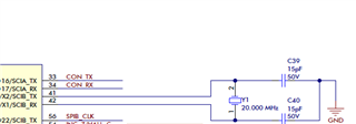

    We are using GPIO 24 and GPIO 32 as mentioned in this table (TMS320F28003x Real-Time Microcontrollers datasheet).Our schematic was reviewed  by TI and had confirmed that we are using the correct GPIOs
  • Najma,
    Matt is referring to the pins that the SCI UART are on. If I look at your schematic, it looks to me like you are using GPIO16 and GPIO17, but the default boot UART pins are GPIO29 and GPIO28.
    Have I interpreted your schematic correctly? I was not involved in the review of this design, so I do not have the details of that review, and if you conveyed specifics about the use case that would have cause TI to validate the [UART] boot pins.
    Stuart
  • Hello Stuart,
    Sorry I was referring to boot mode pins.
    You are right. We are using GPIO16 & 17 for TX & RX.

  • We are using C2000Ware_5_01_00_00. The clock frequency is 20MHz for our board. We haven't made any changes to the device.h file

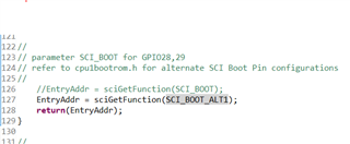

    By default SCI Flash Kernel code uses SCI_BOOT i.e GPIO28,29.
    In order to change to alternate TX/Rx pins for SCI boot, you need to pass parameter as SCI_BOOT_ALT1 (GPIO16; GPIO17)  for SCI to sciGetFunction() in flash_kernel_ex3_sci_flash_kernel.c.
    #define SCI_BOOT 0x01U //GPIO29; GPIO28 (CCARD)
    #define SCI_BOOT_ALT1 0x21U //GPIO16; GPIO17
    #define SCI_BOOT_ALT2 0x41U //GPIO8; GPIO9
    #define SCI_BOOT_ALT3 0x61U //GPIO2; GPIO3
    #define SCI_BOOT_ALT4 0x81U //GPIO16; GPIO3
    These options can be found in the cpu1bootm.h file in the libraries/boot_rom_f28003 within C2000ware.
    Rajeshwary

    Here is what I did
    Open CCS            Project/Import CCS Projects
    Select search- directory C2000Ware_5_02_00_00\driverlib\f28003x\examples - browse
    from the list of discovered projects , selected flash_kernel_ex3_sci_flash_kernel
    opened flash_kernel_ex3_sci_flash_kernel.c and added the right parameters to sciGetFunction to add alternate TX/Rx pins for SCI boot
    //EntryAddr = sciGetFunction(SCI_BOOT);
    EntryAddr = sciGetFunction(SCI_BOOT_ALT1);
    return(EntryAddr);
    Save file
    build project and verified it generated the latest flash_kernel_ex3_sci_flash_kernel.txt

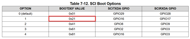

    Since you are not using the default SCI UART boot pins, I believe you will also need to update the bootdef values to point to the correct pins. Otherwise, I don't think the bootrom will even look at the SCI UART pins you have chosen.
    , do I have that correct?
    Stuart
  • Thanks. It would be helpful if you can tell us all the changes that's required.
  • Have a look at this section from the TRM:
    You want to use the appropriate value from this table in the datasheet:
    Stuart
  • I modified both the flash_kernel_ex3_sci_flash_kernel.c and device to h to  add alternate TX/Rx pins for SCI boot.
    But it didn't solve the problem.
    thanks
    Najma
  • Hi Najma,
    Can you please share the code changes done?
    Rajeshwary
  • Hello Rajeshwary,
    - changed the parameter for SCI_BOOT
    - changed the GPIO number for SCI RX / TX
    thanks
    Najma

  • Hello Rajeshwary , I had updated the bootdef values via UniFlash and tried testing it again. But it didn't resolve the issue. Please let me know if you had a chance to review the code.
    thanks
    Najma
  • Hi Najma,
    Code changes seems correct, for further opinion on SCI_BOOT from non default pin option I will ask this thread to be assign to Boot-ROM expert.
    Rajeshwary

    Can you let me know if you have tried the options for custom boot modes in the TRM's section "4.4.2 Custom Boot Modes" already?
    Kedar
  • Hello Kedar,
    I had updated the bootdef values via UniFlash  to point to the correct SCI TX/RX pins that we are using (GPIO16, 17).
    I also modified both the flash_kernel_ex3_sci_flash_kernel.c and device.h to  add alternate TX/Rx pins for SCI boot.
    thanks
    Najma
