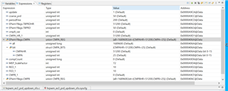

  • My run time code for updating the TBPRD, TBPRDHR,CMPA and CMPHR is as follow:
    EPwm1Regs.TBPRD=coarse_prd;
    EPwm1Regs.TBPRDHR=periodFine*256;
    CMPA_1=(coarse_prd/2) + cmpA_var;
    EPwm1Regs.CMPA.bit.CMPA=CMPA_1;
    EPwm1Regs.CMPA.bit.CMPAHR=CMPA_HR_1;
    // HRPWM_setCounterCompareValue(myEPWM0_BASE, HRPWM_COUNTER_COMPARE_A, compCount); (with thisfunction still no effect of CMPAHR)
    EPwm1Regs.DBRED.bit.DBRED=RED_1;
    EPwm1Regs.DBFED.bit.DBFED=FED_1;
  • Lastly,
    When I change CMPAHR in sysconfig I can see changes in PWM output.
    But I can not change anything in runtime. It is so interesting!
  • Last of last,
    There is this interesting behavior.
    With initial sysconfig settings and after I set coarse_prd=50 and periodFine=0;
    There is 20ns pulse width difference between PWMA and PWMB.
    Then, I change periodFine variable to any number under 255. The PWM frequency changes. Then, I make it 0 as in the beginning.
    Now the 20ns difference disappears. Why, I do not have any idea.
    Also, When I set CMPAHR and CMPBHR different from sysconfig ( changing these in runtime still has no effect). Then, if I change the periodFine any number from zero, there is jitter at the PWMB output. The frequency of PWMB is not stable.

  • Hello Peter,
    I have written multiple of 256 to that register since the beginning.
    In the run time code I multiply the TBPRDHR with 256 therefore I write values  between 0-255 to the TBPRDHR.
    Here is the register values
  • Hi Gokhan,
    Your register view shows the correct values so I'm not sure why you are able to adjust the CMPAHR with the SysConfig but not with bitfield or register writes. Would you be willing to share your project or a subset of your project with us so that we can more easily debug the HRPWM output? I don't notice anything wrong with your run-time code but there may be a HRPWM configuration that's missing which we haven't seen
    Peter
