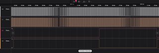

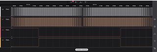

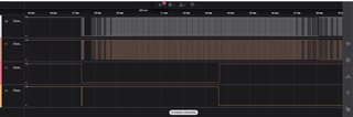

I’m working on single phase inverter using F280049C and following the HV-1PH-DCAC reference manual. I’m having trouble synchronising my pwm signal as I’m using the modified unipolar modulation technique.
I’m using epwm7 (50Hz) and epwm8(20KHz), and my sin reference is being computed in the CLA.
Below are my code and the output of the epwms.
EWPMConfiguration:
     *  Initialization of the  ePWM7 for driving of mosfets
     *  ePWM8 = 20kHz, epwm7 = 50 Hz
     *         epwm8a ->   Q1           epwm7a  ->  Q3
     *         epwm8b  ->  Q2           epwm7b  ->  Q4
     *  Initialization of the  ePWM8 for driving of transistors mosfets
     *  ePWM7 = 50Hz

The epwm output:
I have carefully gone through the c2000 reference manual, followed all instructions and still didn’t get the desired output.
Please help.
