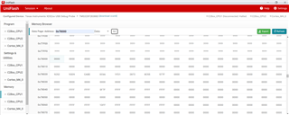

I used the unlock code from the official routine as follows:
volatile long int *CSM = (volatile long int *)0x5F010; //CSM register file volatile
long int *CSMPWL = (volatile long int *)0x78020;
volatile int tmp;
int I;
for (I=0;I<4;I++) tmp = *CSMPWL++;
*CSM++ = 0x93D99252; // Register Z1_CSMKEY0 at 0x5F010
*CSM++ = 0x0C66CABE; // Register Z1_CSMKEY1 at 0x5F012
*CSM++ = 0x28721FD1; // Register Z1_CSMKEY2 at 0x5F014
*CSM++ = 0x577F8C55; // Register Z1_CSMKEY3 at 0x5F016

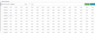

But the console prompts
zone1 OTP flash
DCSM_Z1_REGS Registers

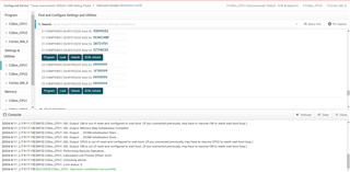

I also try the unlock button in the uniflash setting,but it can't unlock the flash blocks which i choose.
    Please check the GEL file which is a part of your ccxml. Looking at the screenshots you provided, I am suspecting that the CSMKEYs are getting overriden by the default values within the GEL file. Please modify the same and give it a try and let me know if it resolves your issue.
    Thanks & Regards
    Pramod
  • Thank You Very Much.   I think the problem has been solved.
    I don't have a separate GEL file in my project, but I found the corresponding option in CCXML file.
    The default GEL file is C:\ti\ccs1011\ccs\ccs_base\emulation\gel\f28388d_cpu1.gel
    After that I modified the gel file.
    The unlocking operation was successful.
