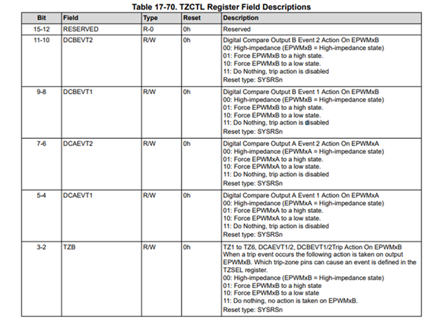

As the interrupt priority shown in TRM, TZB>DCBEVT1>DCBEVT2. If I config TZCTL.DCBEVT1 as 11 to disable the trip action, and use DCBEVT2 to trigger PWM, the test result shows that DCBEVT2 is also blocked, is that phenomenon right?
