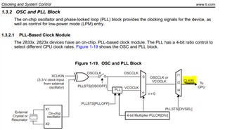

Hi Sagar,
SYSCLKOUT has same frequency as CLKIN derived from diagram below based on PLL settings of the particular device based on user settings.
Please refer to diagram below from TRM (Manual) for more insights.
The SYSCLKOUT is fed to individual peripherals and so yes this is frequency at which the peripheral logic operates on, might be different for some peripherals
For external pins it depends what configurations you have in the peripheral for the output signal, it will output accordingly. For example ePWM you can set the frequency for output signal in ePWM configuration registers and GPIO works accordingly

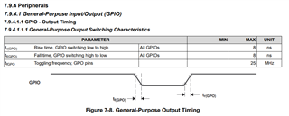

Thanks Prathan for your reply.
ePWM configuration how much max pwm i can set, does it would be 100MHz or 150 Mhz depending on my core supply +1.8V for 100MHz and +1.9V for 150MHz

ePWM frequency is dependent on registers configuration :
PWM frequency is configurable using pwm registers
ePWM max frequency is governed by GPIO limitations in table below :

So basically system clock is internal access the speed at which the internal clock of the microcontroller operates. This clock signal determines the rate at which the microcontroller can execute instructions and perform tasks.
Correct me if i am wrong.
Yes in most cases SYSCLKOUT is source clock that's clear from the diagram below, will be different for some internal logic for peripheral.
