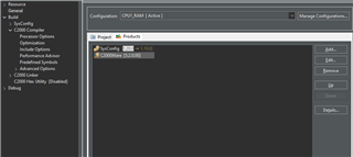

Our sample code can be compiled using C2000Ware up to 5.01.00.00 (also 4.03.00.00 works). However, some of our customers started to install 5.02.00.00 (because they by default download the latest version on ti.com) and now compilation fails. How can we setup the CCS project to be able to compile with both 5.01.00.00 and 5.02.00.00?
