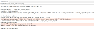

I am getting fatal error whenever I am including the f28379D.h
Can you please help me?

    Please include the file path in the project setting > C2000 Compiler > include options - C2000Ware_5_02_00_00\device_support\f2837xd\headers\include.
    F2837xD_device.h is present in the above mentioned location.
    This path is not included as part of the driverlib examples. You can add them in the include option and rebuild the example.
    Aswin

    I have resolved my issue.
