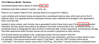

  • I still cannot figure out the root cause. I am thinking about possibly due to cmd file. Please find attached file for your referencef2837xd_flash_cpu1_lnk.zip
  • Please check with the latest command file in C2kware. If there are any changes, try the latest one.
    Did you try the assembly step I suggested.
    Best regards, Pawan
  • 1. What do you mean latest command file in C2Kware?
    2. I tried, but no idea what is going on
  • Check the command file 2837xD_FLASH_lnk_cpu1 in C2000Ware_5_02_00_00\device_support\f2837xd\common\cmd
    For the assembly debug please refer to the assembly user guide and check the CPU registers to understand what is happening and if it is as expected.

  • I use disassembly view. Please find attached
    ESTOP0 is trigger. I use a mouse point to variable input_avgVolt and value is 798.xxxx and DAB_INPUT_VOLTAGE_BROWN_OUT_LEVEL is 740.0.
    I am total lose
  • Hi
    I commended 3 line in link file which I provided before. My code is running ok now
    However, this link file is from TI digital power SDK TIDA_010054 and it is our reference design. I don't know what is side effect if the lines are removed.
    Please advise.
  • Hello Hung,
    You can refer to the Memory Model - Sections chapter of the C28x Optimization User's guide for what the .scratchpad and .bss_cla are used for. The controlVariables section looks like it's its own unique section, so there may be something allocated to it in a #pragma statement somewhere in the application code(otherwise it's unused). If you uncomment these lines and view the Memory Allocations window after compiling your code you can see what gets placed in these sections and that will let you know what possible effect there is. I believe if these sections aren't present, the default related sections are used for memory.
  • Hi Omer
    Thanks for your information. I will take a look the document. However, I wish TI tplain that why these 3 lines removed and the problem is fixed. I am new to this MCU, All logic control is program flow is unexpected.I am afraid of a wrong link cmd file declaration.
