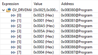

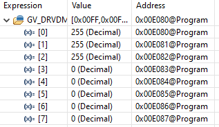

Systematically, at start-up, the first 3 bytes of my DMA buffer are the current state of SPIRXBUF repeated 3 times, and then 4 bytes lost from my frame (= 0) and then part of my expected frame.
Example :
Expected:
  • [0] --> 0x5A
  • [1] --> 0 (Counter)
  • [2] --> 2
  • [3] --> 3
  • [4] --> 4
  • [5] --> 5
  • [6] --> 6
  • [7] --> 7
  • [37] --> 37
  • [38] --> 0 (Same counter)
  • [39] --> 0xA5
All next transmission/reception, I have :
My counter is the same at [4] as at [1], so I interpret that I have received my entire frame, but my DMA has started writing at the 4th byte and looping (even though I don't have WRAP set).
In debug, a breakpoint after activating DMA RX and before DMA TX shows no DMA RX trigger, only when I activate TX.
If you have any clues, I can't understand this problem. Thanks !
  • Damn, I can't update my post, anyway, I'll do it here:
    I've fixed a problem with my slave's transmission.
    This corrected a problem with my counter which appeared identical on bytes [4] and [1] because now I have something consistent.

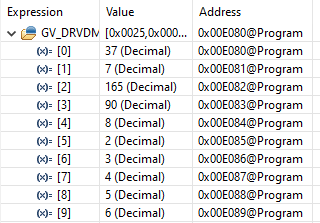

    My first frame received (all 0s) looks like this on the Master:
    After several receptions :
    90 should be the [0] and 165 the [39]
    The problem is still the same, my receive buffer always starts on the 4th. And I receive the second part of my frame at the next DMA activation.
    I hope that's clear to you Grimacing

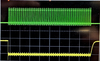

  • You've got it right. The SPI-A uses a FIFO, it transmits correctly (I think) because I have no problem decoding a frame on the slave side (SPI-B).
    On the oscilloscope, I can see my 40 bytes.
    The start and end bytes are well positioned. (MOSI and MISO).
    In my first frame, for example, MISO is low throughout transmission and my DMA only writes 0 from the 4th byte of my receive buffer (SPI-A).
    The problem is identical to the next reception, except that there is data and the end of my reception N is displayed at the beginning of my buffer at reception N+1.
    My main issue is why I can't start my reception (SPI-A) at the beginning of my buffer, always 4 bytes later.

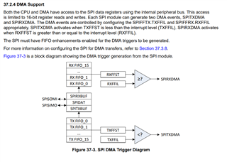

    Since the SPI is operating with the DMA, there is a specific configuration requirement of that the RXFFST is greater than or equal to RXFFIL. Right now, it looks like it's the opposite which inhibits activating the SPIRXDMA. Attaching the other relevant information for SPI DMA operation just to take a look.
    The SPICCR.SPICHAR = 0x7U (8-bit word transmission), so make sure the sent data is left-justified since SPI is optimized for 16-bit transfers. It is suggested to enable high speed mode to reach full duplex speeds, but it is not a requirement, and also make sure that the SPIs have the same clock frequency.

  • Hello Aishwarya Rajesh,
    To answer your questions, I made the following changes before relaunching my tests:
    • I've switched the CH1 to high prority with CH1PRIORITY = 1
    • I have updated the interrupt on my channel 2 (RX) to use SPIA_TXDMA (109)
    • I've activated the SPI High-Speed Mode.
    Before showing you my results:
    • GV_sSpiARegs.SPIFFCT.all = 1 because it made it easier for me to see my bytes with the scope
      I tried setting it to 0 and 5, but didn't notice any change.
    • MODE.CHINTMODE is set to 0 for both channels.
      I also tried setting it to 1 for both channels and I didn't see any change either.
    • I didn't forget to send my data in left-justified. I have no problem seeing my frame on the slave side.

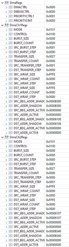

    Here is the state of my registers after initialisation:
    When I start the DMA RX (CH2), the registers don't move except for DmaCh2Regs.CONTROL = 0x2000 (because RUNSTS = 1).

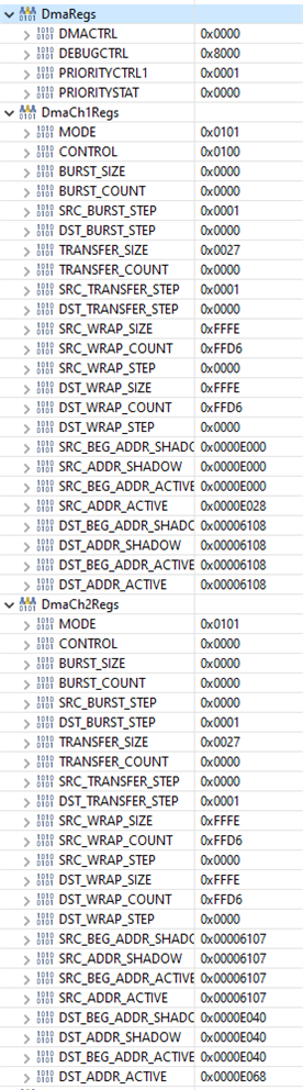

    Now here's the state of my registers, after enabling DMA TX (CH1):
    The result is identical, on my first reception, I have 3 identical bytes of the SPIRXBUF value and then my 0.
    For what it's worth, here's a picture of the signal from my first frame. Green signal is SCK and yellow is MISO.
    Thank you again for your help ! Pray

    I tried your suggestion, I started the code without breakpoint and the behaviour is the same. My frame starts at the 4th byte.
    I've sent you a screenshot of all my DMA + SPI registers and the behaviour is still inconsistent.
    Can you reproduce the problem on your side? Or am I the only one?
  • Armageddon,
    Using the C2000Ware SPI DMA example #5 and your settings, I did not see an issue. If you can send me a friendship request, we can take a look at your SPI and DMA runtime code. In the mean time, let me look into the issue further on my side as well.

    Few more things you can try, if you haven't already.. make sure the SPI polarity/clock mode are the same for the SPIs, check the SPI/DMA GPIO settings (SPI should be async), and make sure you have a separate TX and RX ISR in which you make sure to clear the interrupt group before exiting the ISR.
    These suggestions are based on configurations alone. Do you have access to your program code? It does not need to be running, if that is what you mean.
