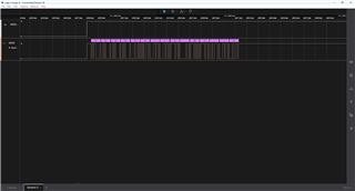

Then we tried SCIB, which is operational but it suffers from the loss of the last 2 bytes of transmitted data. Although, the missing two bytes comes with the second set of transmitted data.  Additionally, the data isn't appearing on Putty (or any other software), but it is being received by the logic analyzer.
Can someone help us to find out the reason why the last two bytes of the TX is missing?

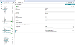

  • We are using CCS 12.7 and C2000 5.2 examples.
    We used sysConfig file to initialize the SCIB.

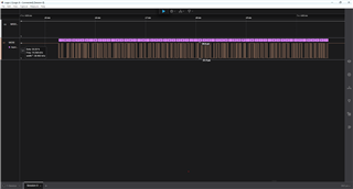

  • First TX packet.
    Excepted output :  "\r\n\n\nHello World!\0"
    what we got :  "\r\n\n\nHello World"
    Second TX packet
    Excepted output :  "\r\nYou will enter a character, and the DSP will echo it back!\n\0"
    what we got :  "!\0\r\nYou will enter a character, and the DSP will echo it back!"
    we are missing last 2 bytes from the 1st packet
    On second Tx we get the missing 2bytes, then the rest of the second packet. Also the last 2bytes of packet are missing, which we get on 3rd TX. and this pattern continues.

    We don't know how to configure the FIFO size as we are using sysConfig to enable the communication protocols.
