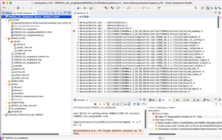

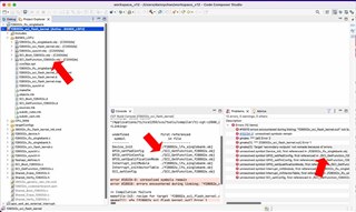

When building one of the example downloaded from TI not from Resource Explorer I have encountered these errors.
see the device.d file, it has path like this, but where's the Ware_3_03_00_00 was defined ? I am currently using C2000Ware_5.02.00.00
device/device.obj: C:/ti/c2000/C2000Ware_3_03_00_00/driverlib/f28002x/driverlib/inc/hw_types.h

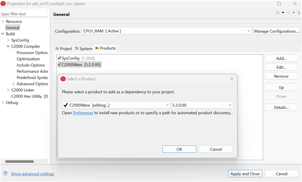

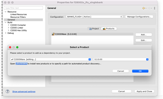

I have checked all properties with updated information / path, with no where entered C2000Ware_3_03_00_00
