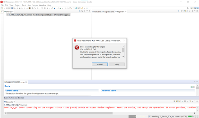

LAUNCHXL-F28379D: Error 2131 using Code Composer Studio V10.2.0
Part Number: LAUNCHXL-F28379D
Other Parts Discussed in Thread: BOOSTXL-3PHGANINV
I'm currently getting an error 2131 when I try connecting to the target device. I'm using CCS V10.2.0. I currently have two different boards. The first board was working and it recently started having this issue. The second board started having the same issue straight out of the box. I also have a BOOSTXL-3PhGaNInv board connected to the launchpad. However, I get the error with or without the daughter board connected to it. My guess is that some of the jumper wires or switches are not being set to the correct position.  I have included a picture of the current jumper and switch settings as well as the error I'm getting when trying to connect to it.
I also noticed that the solution to a similar issue was to connect the JP1 jumper. Can I still do this even if I have to supply power from the BOOSTXL-3PhGaNInv board
Thank you!

  • Hello Omer,
    Thank you for your quick response. The original set up I had when the board was working had the JP6, JP4 jumpers connected, and the rest of the jumpers disconnected.  We also had the BOOSTXL-3PhGaNInv board connected to it and powered up with an external 24V PSU. Do you know if this set up is correct? We are still seeing the error 2131 even with those settings. Please see our hardware set up below.

  • Hello Peter,
    Thank you so much for providing additional information. After probing the board here's what we found:
    Board #1 - Launchpad by itself (old board that worked before)
    JP1, JP2, JP3 are connected, JP6 is disconnected.
    We measured at the same point as the previous test. We got 5V on the 5V pins and 0.3V on the 3V3 pins.
    NO LED lights were On, on the board.
    Boards #1 - LaunchPad + Booster Pack (old boards that worked before)
    JP6 connected & JP1, JP2, JP3 disconnected.
    No power to the 3.3V, 5V pins. I measured the pins that are next to the quadrature pins. (Bottom of the board with the TI logo facing up- opposite to the micro-USB connector). We measured roughly 0.3 V on the 5V and 0.2V on the 3V3.
    The LED D4 was on. LED's D7, D8 were also on/off every 3secs roughly. The LED D5 on the Booster Pack was also on.

  • Hi Nelson,
    It seems your old board may have been damaged, is that the board that is pictured in the image? Can you measure all 3.3V pins on the boosterpack headers as well as the 3.3V test point on the board? The jumpers that are populated should be enough to provide the 3.3V power and the power good LEDs should be lit in this instance
