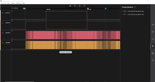

I am generating PWM signal for my power electronics project and I would like to verify the behaviour of my PWMs.
I am using PWM7 at 50 Hz and PWM8 at 20Khz and PWM7 is the master.  The initialisation code of both are called at the same time, PWM7 first then pwm8.  However, there is always a 90 degree difference in the start of both pwm, i.e, the PWM8 starts after a delay of 90 degrees.
I want to ask if this is abnomal and how can I configure the two PWM to start at the same time (without this 90 degree delay).

    The above sequence was what I used in the configuration of my EPWMs.  A snapshoot of the waveform is below
    The waveform marked P0 is the PWM7 and it should be 20ms and not 15ms and this is the first pwm (duty cycle) at the starting of the pwm.  This lead to the permanent 90 degress delay, which is propagated through the entire waveform
    The waveform marked P1 is for the pwm8 and this pwm starts normally and ends normaly which is for a period of 20ms.
    I have reviewed the entire code but I did not fine the cause of the problem.  I have also looked at the pwm examples but could not solve the problem.
    I anticipate your feedback.
    Thanks.

    I'm a bit confused by the image you shared - are your PWM waveforms all shown on channels D0-D3? How are P0 and P1 generated? P0 and P1 refer to the period of the PWMs? Are you still seeing the correct frequency outputs? Just want to be sure I'm understanding and interpreting correctly.
    In your initializations in main() are you starting all of the EPWM counters at the same time? The TBCLKSYNC bit when set will start the time base counter (TBCTR) for all of the epwm modules within the corresponding CPU selected. From the device TRM:

    1.  The red pwm train is for pwm7 and at 50 Hz.
    2. The orange pwm train is for pwm8 and at 20khz.
    3. The both pwms are meant to start at the same time and when the pwm7 completes a cycle, the pwm8 should have made 400 cycles or a period of 20ms but in the waveform we see that the first duty cycle of the pwm7 does not correspond to this. Hence this permanent delay of 90 degress.
    3.  The markings are to look at the timing of the pwm trains.  The two PWM are started together and a should be alligned but this is not the case
    4. The marker P0 shows that the first pwm cycle of the pwm7 is not a complete cycle of 50Hz (20ms) but is is trucated to 15ms.  All other duty cycles are correct but this 5ms that is cut off the first duty cycle removes the allignment from the two pwms
    5. The marker P1 shows pwm8.  It starts as expected and after 400 cycles gives a totatl period of 20ms or frequency of 50Hz.
    I hope this helps explain my observation and problem with pwm.

    Yes please check that your application is starting up the EPWMs as I mentioned and let me know.
    Could you also please share your EPWM configurations? What are your action qualifiers?

    I have thoroughly verified my code and implemented all our chats and tested the code but the situation is still the same.
    I am attaching the pwm code for you to reveiw for me.

  • Hi Abayomi,
    I see that you are using up-down count mode and EPWM7 action qualifiers are the following:
    • EPWM7A:
      • CTR = 0 --> low
      • CTR = CMPAU --> high
      • CTR = CMPAD --> low
    • EPWM7B:
      • CTR = 0 --> high
      • CTR = CMPBU --> low
      • CTR = CMPBD --> high
    Where CMPA and CMPB are the same variable (same value). This appears to match what we see in your waveform image:
    My confusion is that it looks like your "P0" delta is measuring from CTR = 0 to your counter compare value (CMPA/B), rather than a full cycle. Please let me know if I am misinterpreting the measurements, but this looks expected to me. The counter should be reaching '0' to finish the PWM cycle at around where you have the green "P1" measurements.
    As long as you are setting TBCLKSYNC to 0, then configuring the EPWMs (setting CTR values to 0 to initialize them) then setting TBCLKSYNC to 1 after configuring, then you should be starting the clocks at the same time.
    As a test, could you please change the action qualifiers for both channels of EPWM7 so that the only actions are to set high on CTR = 0 and set low on CTR = PRD. Then when you measure EPWM7, take the time delta between rising edges. This should be your full cycle time.
    Allison
    I have solved the problem and the solution is similar to your recommendation above.
    I set the action qualifier to change when counter is either = 0 or when it is = period.
    Thanks.
