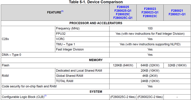

From SPRSP45B I have this info:
If I understand correctly, only F280025C/F280023C have 2 tiles of CLB and the others does not have any CLB.
Could you please confirm that?
Thank your and regards.

Hello Quy,
Yes, that is correct.
