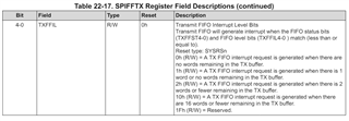

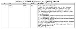

    1. Specifically, the interrupts for SPI and how exactly the transmit interrupt is triggered in this example "spi_ex2_lookback_fifo_interrupts" since there is nothing in the program to fill the transmit FIFO thus how is it possible for the ISR to trigger?
    The advantage of using both FIFO mode and interrupts is that the interrupts are triggered based on the level of "fullness" of the transmit and receive FIFOs. This is all triggered by the hardware rather than the software - hence why you may be confused as to how the transmit interrupt (SPI TX ISR) is actually being called (because there is no software action needed to initiate calling of the interrupt).
    When you configure the SPI module, you can define the SPI TXFIFO and RXFIFO levels. The "level" refers to how much data is present in the FIFO (and also indicates how much space is available in that FIFO). When you select a FIFO level, this means the respective transmit/receive interrupt will automatically be triggered (by the hardware) when the FIFO is at that level. So in the case of the example2 from C2000Ware, when you open the SysConfig file, you can see that the TX and RX FIFO levels are both set to 2:
    For the transmit side: the TX interrupt will be triggered when the TXFIFO has 2 or less words in it (meaning it has at least 14 or more spots available in the TXFIFO since the FIFOs are 16 levels deep). See the register description from the device TRM below:
    For the receive side, the RX interrupt will be triggered when the RXFIFO has 2 or more words in it (meaning the receive FIFO has at least 2 spots full of data). See the register description from the device TRM below:
    So as soon as you start your program, the SPI module recognizes the TXFIFO is empty (or, rather, has 2 or less words in it) and triggers a TX interrupt where you should be writing to the transmit buffer to send out data. Let me know if there is still confusion here!

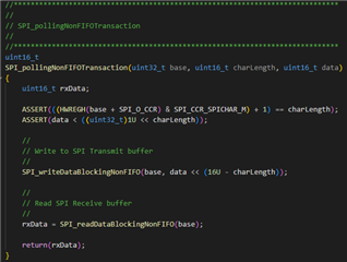

    2. Additionally, has anyone fixed the SPI driver for "SPI_pollingNonFIFOTransaction". I still have erratic clock behavior that others see here when using that: https://e2e.ti.com/support/microcontrollers/c2000-microcontrollers-group/c2000/f/c2000-microcontrollers-forum/1248486/tms320f280025c-issues-with-manual-control-of-cs-pin-in-spi-when-using-driverlib-functions/4726334?tisearch=e2e-sitesearch&keymatch=SPI_pollingNonFIFOTransaction#4726334
    Yes, this has been fixed in the latest C2000Ware version 5.02.00.00! Please download the latest version and be sure your project is using this version of the drivers instead.

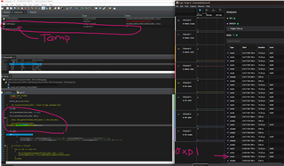

  • Looks like im not out of the woods yet.
    For some reason the SPI Controller is not properly transmitting data still. As you can see I get a value of 0x0C for WREN in the EEPROM example but it is 0x06. I see the same behavior throughout all function calls to transmit as well as trying to use GPIO for Chip select.  Im out of ideas.
    Attached are pictures of the problem:

  • I am able to successfully transmit to my SPI devices to configure registers - this works. The problem is reading back from the SPI controller. My Salaea can see the receiving bits being shifted out using receiveByte and dummyData but the return of this function is not what I am seeing on my logic analyzer.
    Could you explain a bit more of the context of the issue?
    -> The F280015x is transmitting data successfully now using SPI_trasmitByte HAL but SPI_recieveByte doesnt return the received value that I am observing using a logic analyzer.
    Are you sending/receiving other data and it is correct but only 0xD1 is incorrect? Is the F280015x the controller/master device?
    -> Yes The F280015x is the MASTER device. The 0XD1 is being received by the Logic analyzer from the slave device (successfully) but the reiceveByte HAL doesn't return this value. This does mean that the dummybytes being shifted out reiceveByte successfully so this is somewhat working.
    The SPI_receiveByte is supposed to receive data that is sent to F280015x and store it into the temp variable
    -> This is exactly what I am doing with it right now but its not working. In the end I need to receive 18 bytes and Im trying to use reiceveByte in a little FOR loop to do this. But for testing, I'm trying to just Receive one byte which isn't working.
    Keep in mind that I am using GPIO Chipseelct control (Which is working great btw!)

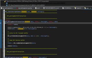

    One thing to help double check would be to set a break point at (or before) that line 236 where you have the SPI_receiveByte(), then run the program to/before that line and then use the "Step into" and "Step over" buttons to look at what is happening. Please try to go line by line through the receiveByte function (should jump to the spi.c file to do so when you "Step into" the function and into the SPI_pollingNonFIFOTransaction() since that is what receiveByte() uses).
    You are still using the latest C2000Ware driverlib, right? Recall that there was a bug with the old version of the SPI_pollingNonFIFOTransaction(). The corrected version should look like this:

  • Temp variable is a Uint16_t type. I just checked the SPI_pollingNonFIFOTransaction() in new Driverlib 5.0.02 and its the same as your screenshot. I can step through it and I still get nothing RX.

  • Hmm strange - to clarify, you are seeing the correct activity on the MISO line, but it's just not getting saved into the temp variable? When you check the SPI RXEMU register during run time, do you still see the correct data being received in the SPI RX buffer?
  • Yes exactly my logic analyzer is hooked up to the SPI lines so its seeing the same bus as the C2000 but SPI RXEMU is 0x0000 weirdly enough.
  • Some rudimentary questions I feel I must ask just in case Slight smile:
    • Just want to clarify that you see the corrected function (that I screenshotted above) when stepping into/through the receiveByte in your actual program? Sometimes what happens is even if you download the latest C2000ware, CCS doesn't pull in the driverlib changes unless you manually rebuild the driverlib library in the CCS workspace, so I just want to be sure this isn't the issue.
    • Another quick check- you have the continuous refresh turned on when you are checking the registers and expressions?
    • Are you receiving data at any other time during the program that you can check to verify that the RX line is functioning otherwise?
    Another idea would be to try using loopback mode (where RX and TX are tied together internally) and send test data and check that it is received correctly to verify at least the software configurations are ok and perhaps hint at some hardware issue.

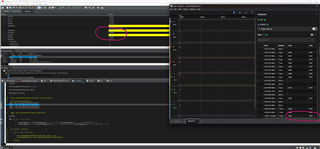

    • Here is a screenshot of the first
    • Continuous refresh is enabled.

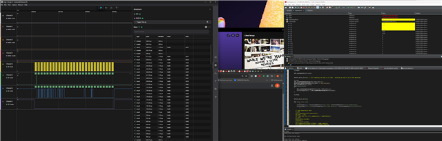

    • Here is a picture of the SPIEMU register. its RXing 0 while logic analyzer is seeing 0x64. Yes I am able to RX values
    RX never works. Its either 0xFF or 0x00.
    The loopback test works great on the chip. Ive tried both driver lib examples. I don't see how it could be hardware if I can read it on saleae right?
  • Its hardware. The diodes I used for the shared MISO SPI bus are not capable of switching fast enough. My old rigol scope is broken - it wouldn't ever trigger so I could never see it but I finally can see it by enabling the analog view in Saleae. The Saleae spi decoder is MUCH more sensitive than the SPI controller in the C2000 and that's why I could see valid data otherwise.
