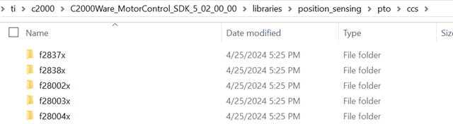

Hi Team,
Does the F28P65 support PTO? I download the newest SDK, but can't find F28P65 demo.
If support, how to port to F28P65?
Zane

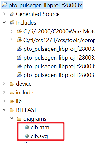

Hi, Lori
I create a static library CCS project, and add sysconfig in project, then I compared with F280039 project to configure CLB, and then porting code to F28P65 project. After many modify, it can be built successful. But don't generate clb.html/clb.svg, could you help me find out where is wrong?
pto_pulsegen_libproj_f28p65x.zip
Zane
