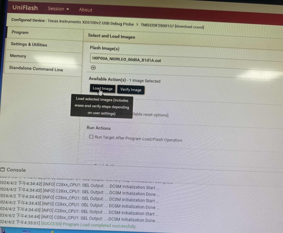

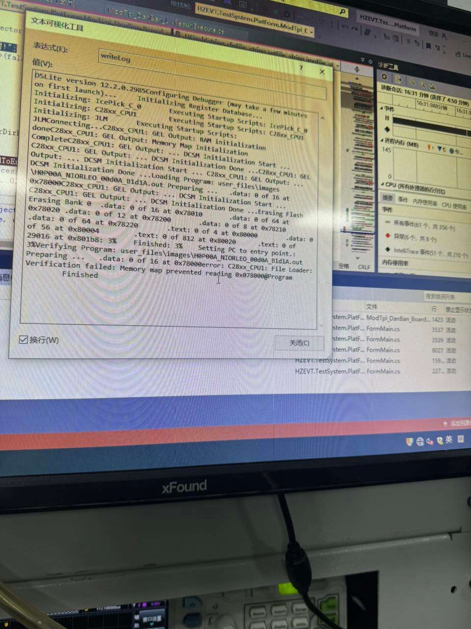

Customer met verification failed   issue when use command line to program the code which with JTAG lock.     you can refer to  below picture and command :
Uniflash_Windows_64_157\ccs_base\DebugServer\bin\DSLite.exe flash -c "user_files\configs\f2800157.ccxml" -l "user_files\settings\generated.ufsettings" -s VerifyAfterProgramLoad=2 -e -f -v "user_files\images\H0P00A_NIORLEO_00d0A_B1d0D.out"
but with the same  .out file , if program in UniFlash GUI like below, will no this issue,
Could you  help check the reason?

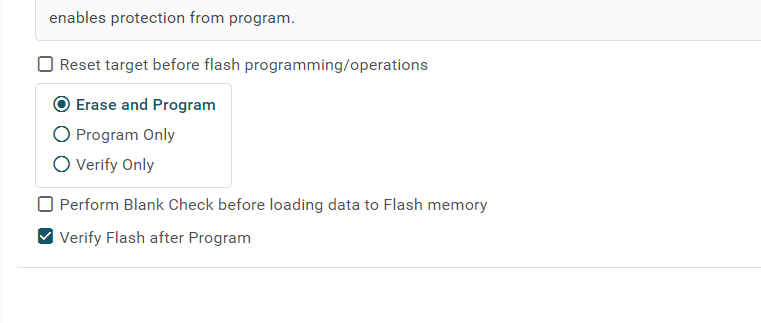

  • Hi ,
    The verify settings between the two might be different.
    Is Verify after program enabled in Uniflash settings?
    I believe a verify (read) of the JTAGLOCK location after configuring it will lock the JTAG.  I can check with our DCSM expert after you clarify the Uniflash settings.
    Thanks and regards,
    Vamsi
  • Hi Vamsi,
    Yes, Verify after program enabled  in  Uniflash settings.

    We need to check if there is any other verification (like the verification by debugger) is involved apart from the flash DLL initiated verify.
    A read (verify) of the programmed JTAGLOCK location will cause the JTAG to lock permanently.  Flash DLL based verify does not read JTAG LOCK location.

  • Hi Huihuang Chen,
    Can you ask customer to not include -v in their dslite command?
    The -v flag invokes debugger based verification (which does not know that JTAGLOCK location should not be read).
    Also, -v flag is not needed since the flash plugin will verify the programmed content in the flash (apart from flash state machine verify) anyways.
    Thanks and regards,
    Vamsi

  • Hi Huihuang Chen,
    -v flag is different from "Verify after Program".
    -v flag is debugger based which has no intelligence on what fields in memory it is reading to compare against the user provided image.  It reads every location in the image.
    As you might have noticed in the GUI, "Verify after program" option would be enabled by default.  If you still want to include the flag enable for it, you can add "-s FlashVerifySetting=true" to the command.
