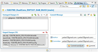

I'm looking to manage my version control using Git and integrate GitHub into Code Composer Studio. Could anyone help me with this?

Hi Ryan,

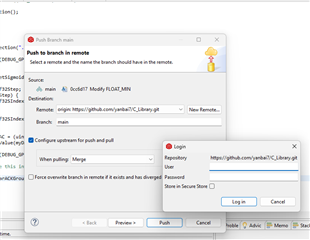

I've referred to this page, but when I push with GitBash, it works fine. However, when I press "Commit and Push" in CCS, a dialog pops up asking me to log in. But now GitHub doesn't require login, so I should be able to push directly. Even if I log in, it keeps popping up with errors saying I've logged in incorrectly
Could you please assist me with this?

Hi Cody,
We also have a user guide for the EGit on CCS. This seems like an authentication error. Could you make sure that you've configured your git identification correctly? Can you show the errors that are displaying?
https://wiki.eclipse.org/EGit/User_Guide#Configuration
Ryan Ma
This link will help solve this issue. You have to use token based authentication instead of username / password. I cannot help any further since this is now a github related issue.
But, I would suggest creating a ssh key.
